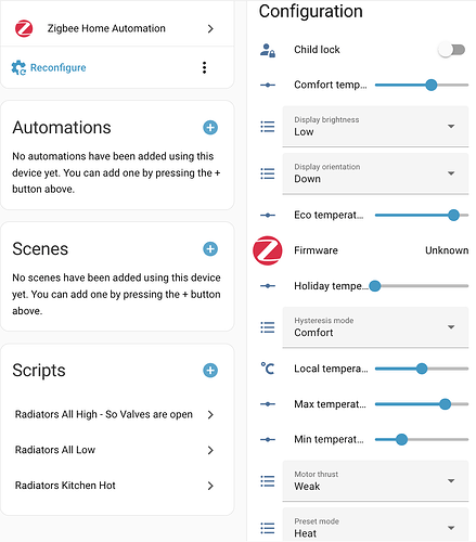

I have a few Tuya TRVs with device ID: _TZE204_ltwbm23f
They have an “Eco Mode” and decide every night at 22:00 to change to their Eco Temperature setting - not the temperature I configured. These are the configuration settings I have to play with and I have no idea how to stop the TRV from reducing the temperature setting. Does anyone have any idea?

I think I may have found an (ugly) solution. When my automation sets the target temperature to e.g. 20, add an Action, Number, Set Number, to set the Eco Temperature to 20 as well. So even it it changes to eco mode, it doesn’t change the target temperature. Hopefully that works.

My proposed solution seems to work reasonably well. I have about 10 Automations, and they all use 2 scripts each (Set Hot - Set Cold) per group (e.g. Living Room Set Hot / Living Room Set Cold) and I updated those scripts to also set the Eco Value to the same value as the Hot/Cold value. That seems to do the trick although I think it’s not a very pretty solution.

Another “fix” for people suffering this problem. I figured out that when the “Hysteresis mode” of these devices is set to Eco, the TRV’s switch off when the target temperature reaches the Eco temperature. I have no idea why but that’s the way it is on my TRV’s
I fixed that through an automation which switches it back the moment the Eco Mode kicks in (and yes, I had to do it a few times for it to work)
