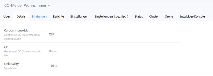

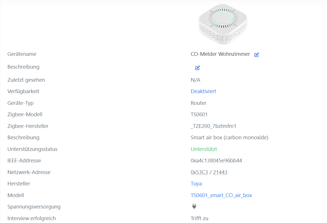

I’m completely new to Home Assistant and have no prior experience with it. I recently purchased a Tuya TS0601_TZE200_7bztmfm1 CO detector (Tuya TS0601_smart_CO_air_box control via MQTT | Zigbee2MQTT) and connected it via Zigbee2MQTT. To test its functionality, I placed it in a sealed container and used incense sticks to simulate smoke. However, the ppm value remained at 0ppm and did not change.
Now I’m wondering whether the CO detector is defective or if I made a mistake during the integration with Home Assistant. Do I need to configure anything else in Home Assistant to get the CO detector working properly?

  • does your device expose entities in z2m? (it’s the tab to the right from where you took your screenshot)
  • Tuya devices: they use zigbee but that doesn’t mean they play nice with the standard
  • next time you buy a device, check if it works/is supported
Apparently, TS0601 doesn’t specify the device itself and if you do a search here on the forum, you will get multiple threads with issues related to that ID.
Many users steer away from Tuya because of difficulty to integrate them in HA.
Yes, entities are displayed. Also, there were no errors or warnings in the log during the integration.
Which Zigbee CO detectors work well with Home Assistant? Have you already had any experience? I’d consider buying one based on your recommendations.
Do those values change?
Sorry, can’t recommend you anything since I don’t use them but there are quite some discussions about these type of devices here.
I cannot change these values. The values did not change during my test either.
Of course you cannot change them yourself: these values should be the result from the sensors and if working correctly, passed on to HA.
They should change though when circumstances are changing.
Yes, but the values did not change during my test.
I’m out of ideas…
