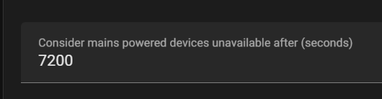

You won’t be able to see it drop off the network unless it fails to report back for 2 hours. That’s the default reporting interval in ZHA
In my case (on Z2M), the device simply disappeared from the devices list, like it never existed. Z2M has a tighter timeout (10 minutes) for mains devices, so that might partly explain it.
