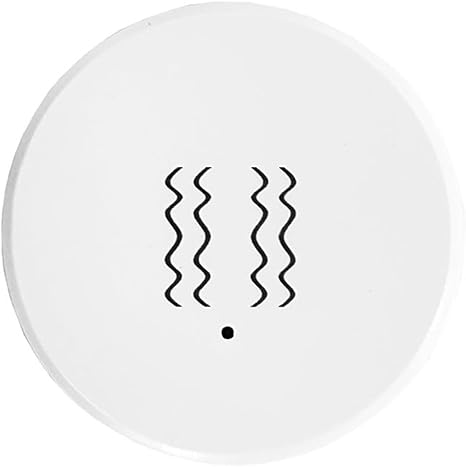

Hi everyone, I have a Tuya zigbee vibration sensor integrated with zigbee2mqtt, home assistant manages to integrate it but the status is always absent, in a post here on the forum it was about external extensions but it still doesn’t work ,it is recognized as TS0210
in the editor file go to the zigbee2mqtt folder and in the additional external_converters folder, here create a file with js extension and paste the code you find here [New device support]: New Fingerprint for ZG-103Z, currently detected as TS0210 with no functionality · Issue #28652 · Koenkk/zigbee2mqtt · GitHub into it, remove the sensor, restart zigbe2mqtt and pair the sensor for association
