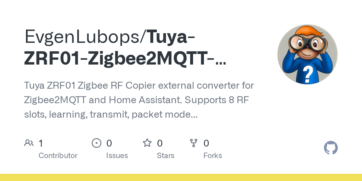

UPDATE — SOLVED: Tuya ZRF01 is now working locally with Zigbee2MQTT + Home Assistant
I finally got the Tuya ZRF01 working properly with Zigbee2MQTT and Home Assistant.
Device:
Model: TS0601
Manufacturer: _TZE284_tdg4ckyh
The solution was to use a Zigbee2MQTT External Converter.
After installing the converter, Zigbee2MQTT exposes all 8 RF learning slots and all 8 RF transmit controls.
I successfully tested:
• Learning 433 MHz fixed-code RF commands
• Saving commands in the RF memory slots
• Transmitting learned commands directly from Zigbee2MQTT
• Controlling the ZRF01 from Home Assistant through MQTT
• Local operation without Tuya Cloud
In my real setup:
RF Slot 1 → Main gate
RF Slot 2 → Wicket / pedestrian gate
The complete control chain is:
Home Assistant → MQTT → Zigbee2MQTT → ZRF01 → 433 MHz RF
I created two buttons in Home Assistant and tested both from my smartphone outside.
Both the gate and wicket work correctly.
External Converter + installation instructions:
I also recorded the complete setup and real-world test.
One issue remains on my device:
The illuminance entity is exposed by the converter, but it stays unavailable and does not report any values through Zigbee2MQTT.
Standard fixed-code 433 MHz remotes work correctly in my tests.
Protected Rolling Code / encrypted RF remotes generally cannot simply be learned and replayed.
If anyone has another ZRF01 hardware revision or another manufacturer ID, please share the device information. It would be useful to compare the Tuya datapoints and potentially extend support to other variants.
