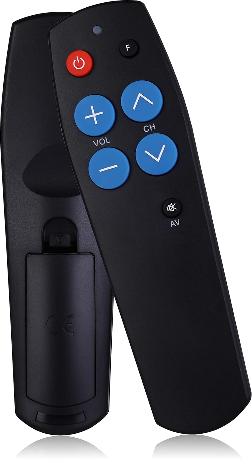

A simpler solution might be a big button remote instead.
