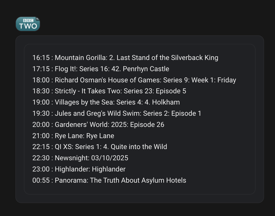

Basically am downloading Freely one huge file, then splitting out into individual files for each channel. These are all hosted on GitHub to stop others hitting their link too often. Updates daily at midnight + 5 mins. Just doing daily schedules at the moment.
Managed to get some time before bed, copied, pasted and it works a treat. More investigation after the weekend. Fingers are crossed!
Made some tweaks to what shows. Should update at 4am now. Descriptions are empty due to the source info. So put secondary info there. Still working on images, but in no rush.

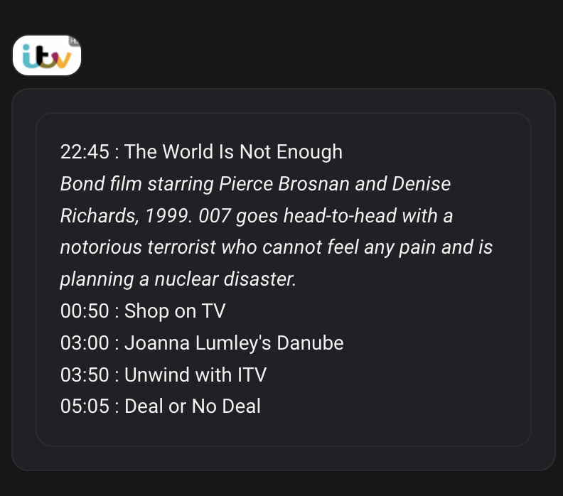

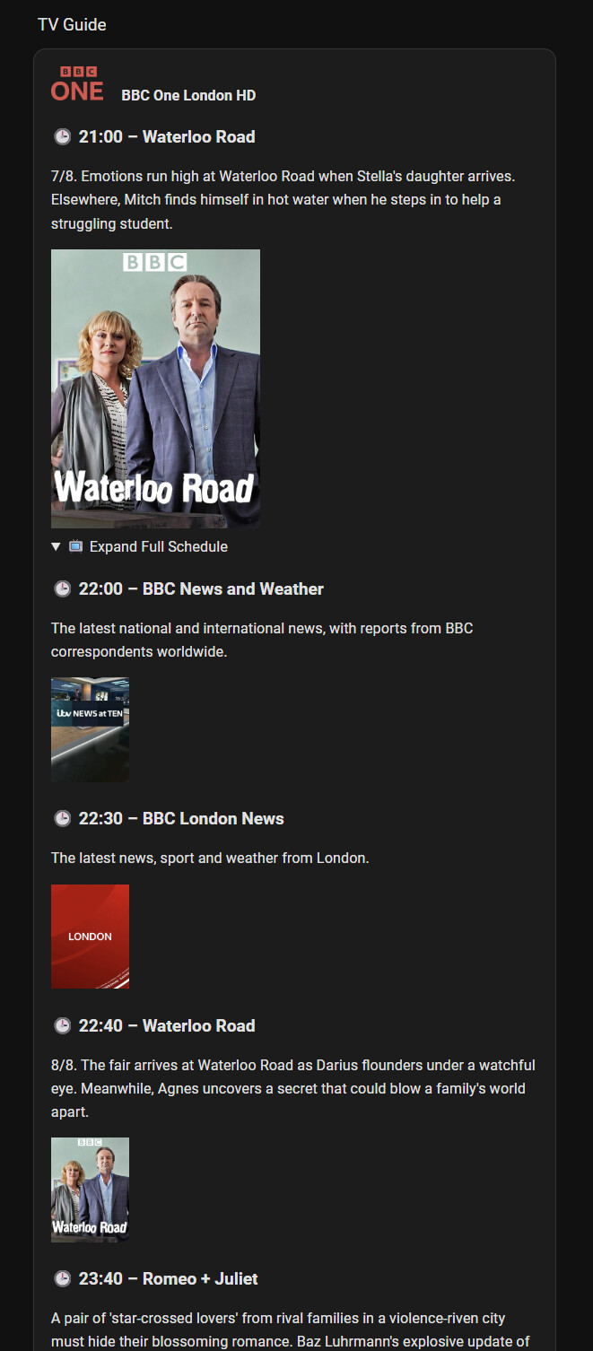

Just for info, I also made a new implementation (screenshots below)… let me know if anyone wants to know how I did this…
I did this using a hacked version of HA-EPG integration.
It uses this XML feed… https://raw.githubusercontent.com/dp247/Freeview-EPG/master/epg.xml
The original HA-EPG uses a different feed without images, so I modified it to use the above feed to create a dictionary attribute of the entire today/tomorrow schedule with images.

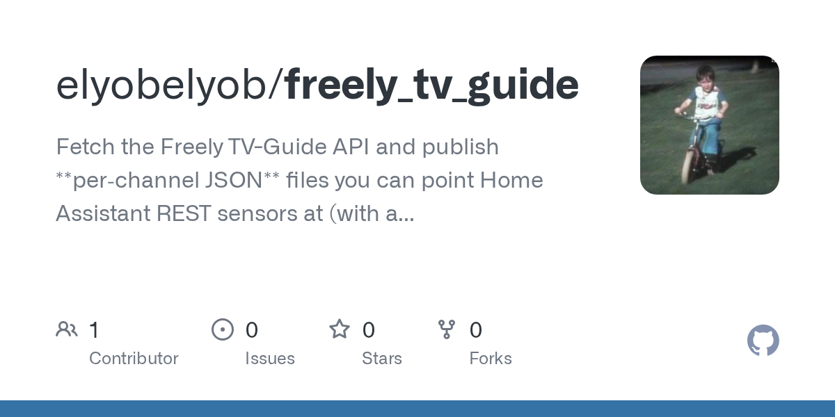

In case it helps, I created GitHub - elyobelyob/freely_tv_guide_new to use that xml also … but to split into channels as I prefer …

I’ve done a bit of tinkering with your excellent work on the upcoming/expandable schedule, still working on the formatting but the info is there…
