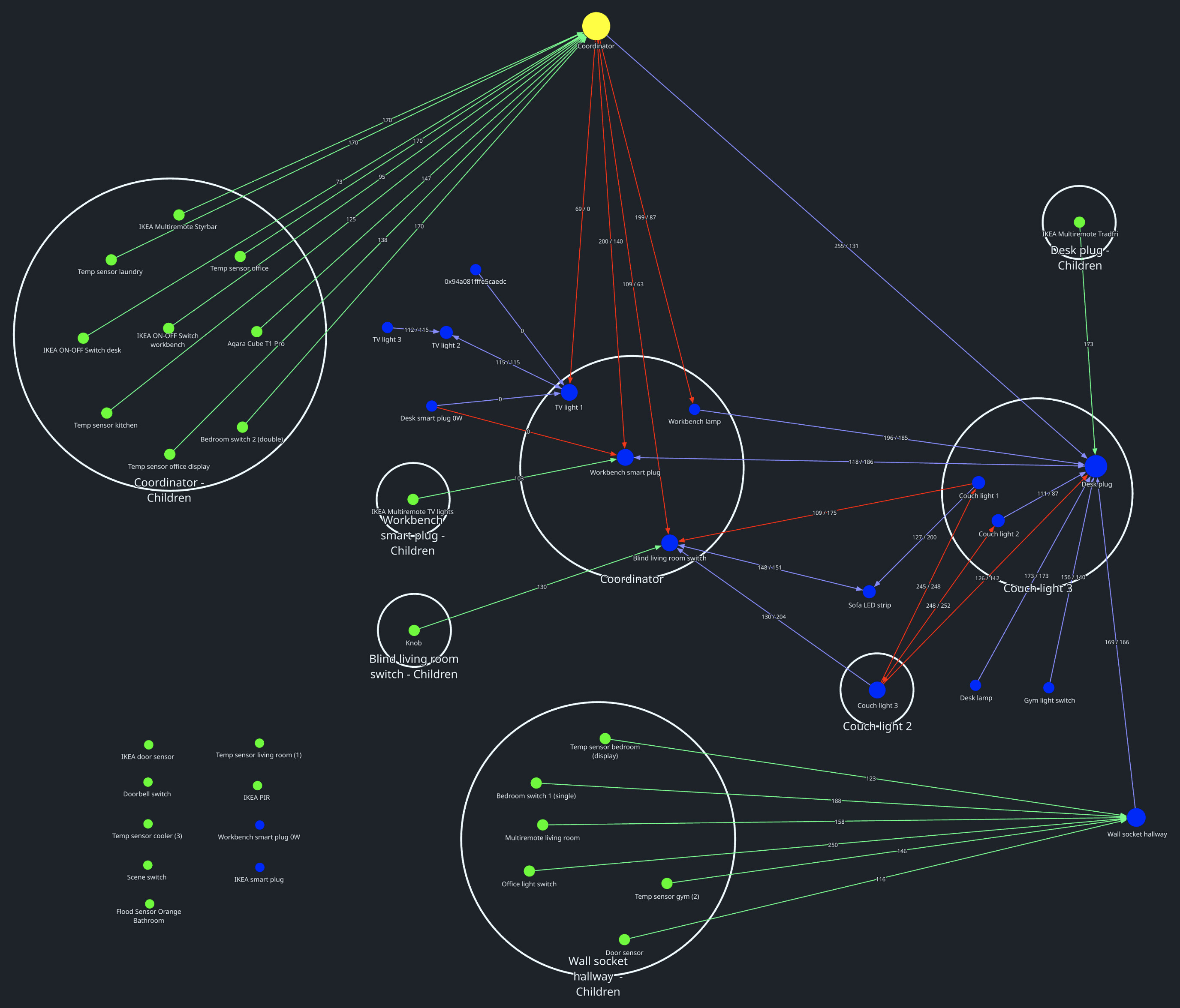

Two coordinators shown in my network
To my (limited) knowledge, there must be just one coordinator in a Zigbee network. Right?
A week ago or so, my automations became sluggish or unresponsive, with a lag of a random number os seconds or even not responding at all.
Digging a bit, I found that devices didn’t report or changed state through the Z2M web UI nor publishing payloads to the MQTT broker.

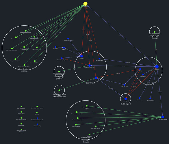

I realized then that two coordinators are shown on the network map, one is the actual coordinator (big yellow dot) and the other one was a wall switch. I removed the switch from Z2M and now the lag problem looks to be fixed (or the lag is almost unnoticeable), but the map still shows two coordinators, i.e. the coordinator itself and a bulb.
I didn’t see that parent-children relationships in previous Z2M versions either.
Is there a malfunction/misconfiguration or is this normal and I need to review my Zigbee knowledge?
Most of the unconnected devices are battery powered and a few of them are indeed disconnected.

Well there appears to be 1 coordinator in that picture.
Why do you think there is 2? The coordinator is the yellow dot. Special software is loaded into the coordinator to coordinate, so if you didn’t do that, it didn’t just load itseld.
Most mains powered zigbee devices route, that is what you want to happen.
Most likely whatever disruption if there is one is due to not enough routers for the number of end devices that do not route.
You can study more about Zigbee Protocol in several posts in this list:
Read the link @Sir_Goodenough has kindly provided for you. Zigbee works as a mesh network.
What you’re seeing is:
  • Yellow dot: your 1 & only coordinator.
  • Blue dots: zigbee routers which should form the backbone of your mesh
  • Green dots: end devices, usually battery powered.
Look at the map you posted & pay careful attention to the circled yellow & blue dots. The red line between them means they might have trouble communicating (especially since they’re passing traffic from the green end devices too).
Again, read up on zigbee & go buy more routers

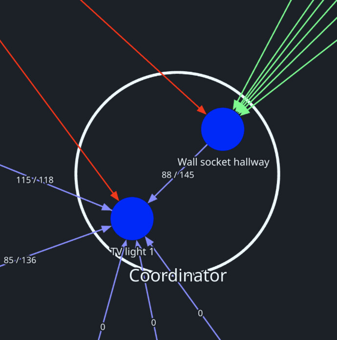

Thanks for your replies and the link. I’ll read it carefully. I already know about the topology, roles, etc in a Zigbee network, but I’m far to consider myself an expert.
What confused me is this one in addition to the actual coordinator:
That label led me to think it is a second coordinator (these are an Ikea bulb and a wall socket from Aliexpress)
I face the similar issue. From the legend, red arrow indicates “Parent” relationship and Blue Dot represents router, but the label states coordinator and I’m wondering if it is normal.
I do not have the same integration, but from wht I see all circles show what the devices are connected to, not what they are. So the two pointed at are connected to the coordinator, they are not the coordinator.
Same issue, the conclusion is what ? does the direction of arrows normal from coordinator to router ? it should be the opposite ? right ?
The conclusion is people are misinterpreting the graph, same as you. Is there an actual problem of things not working as they should?
Yes, I initiated this topic because the network was extremely slow and unstable and thought something may be wrong.
Does the big circle named Coordinator simply mean these routers are connected to the coordinator?
Then, the clients in the circle named Coordinator-Children are children because these are not routers, right?
I know a Zigbee network can only have by design one coordinator so most likely I’m misinterpreting the map.
