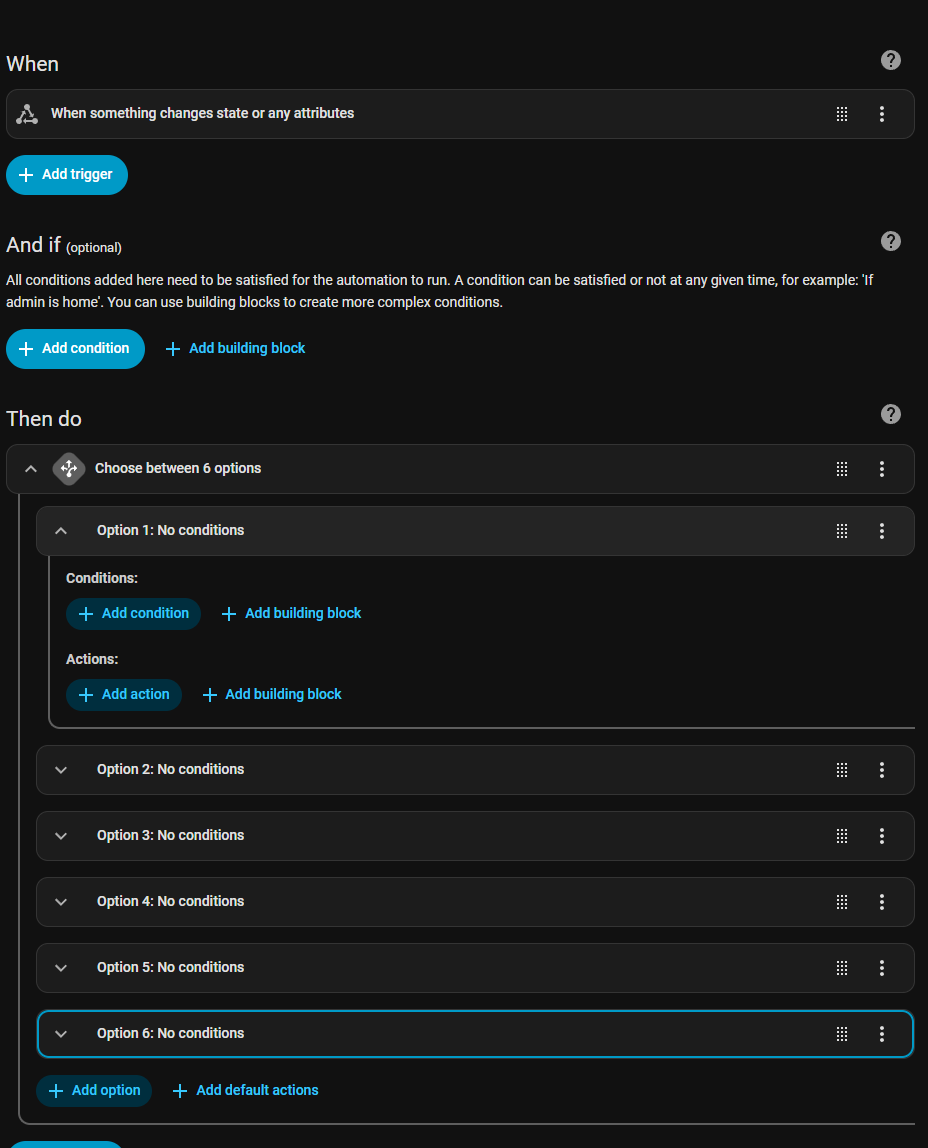

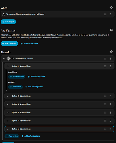

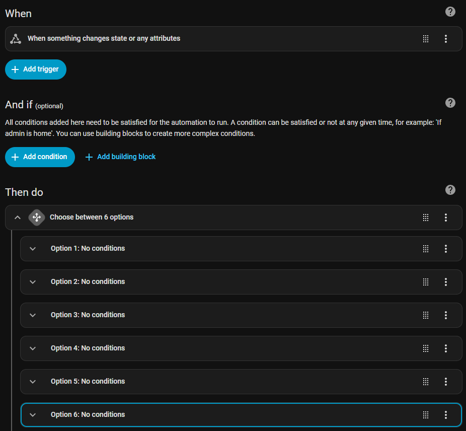

But if im understanding correctly: You would only need one trigger and then you use my favorite building block “Choose” this allows one trigger to have multiple condition and automation routes
Example: my light turning on is the trigger
Choose state allows unlimited options under it so i can say…
-when my light in on & no presence detected for 15 sec turn it back off (option 1)
-when my light in on & presence is detected for 10seconds do something lol (option 1)
but this is the way to go, i have blueprints that heavily rely on this
Choose states allows you to run advance conditions when you set condition to a template!

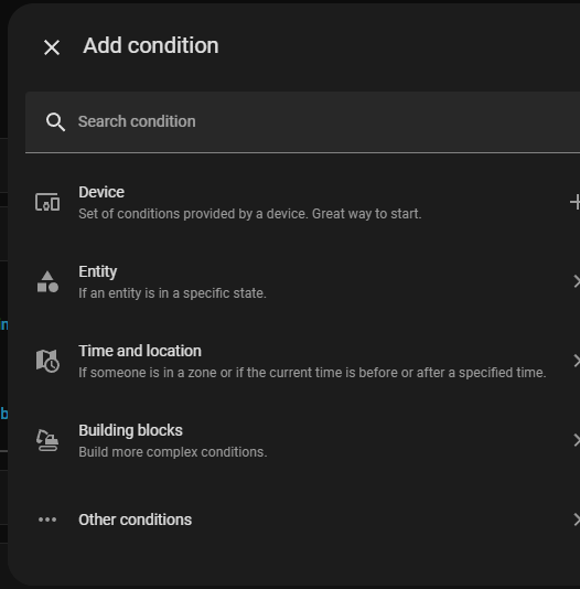

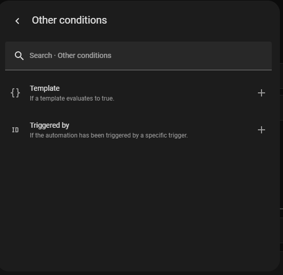

Yes, it’s totally doable using just the UI. All you need to do is add a separate Trigger ID for each trigger, then use a Choose based on that Trigger ID, with each path having its own conditions & actions.
