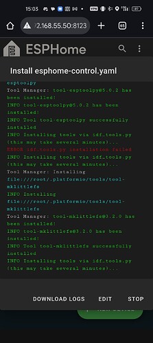

I have similar problem on RP4 4gig, now even down to 2025.10.5
Even after reinstalling addon when trying to update board.getting same error.
You are not showing any errors and please use the code blocks to make it possible to read them. Pictures are a very poor substitute.
How to help us help you - or How to ask a good question - Configuration - Home Assistant Community
How to use code blocks to make your code and logs readable
Markdown Cheatsheet · adam-p/markdown-here Wiki · GitHub
I would, but dont have PC by hand now, but to be honest HA is used 99% on phone.
Error is on screenshot! Tried to compile in different remote location with HA on PI4 2gb and it worked. Unfortunately can’t update from there…
