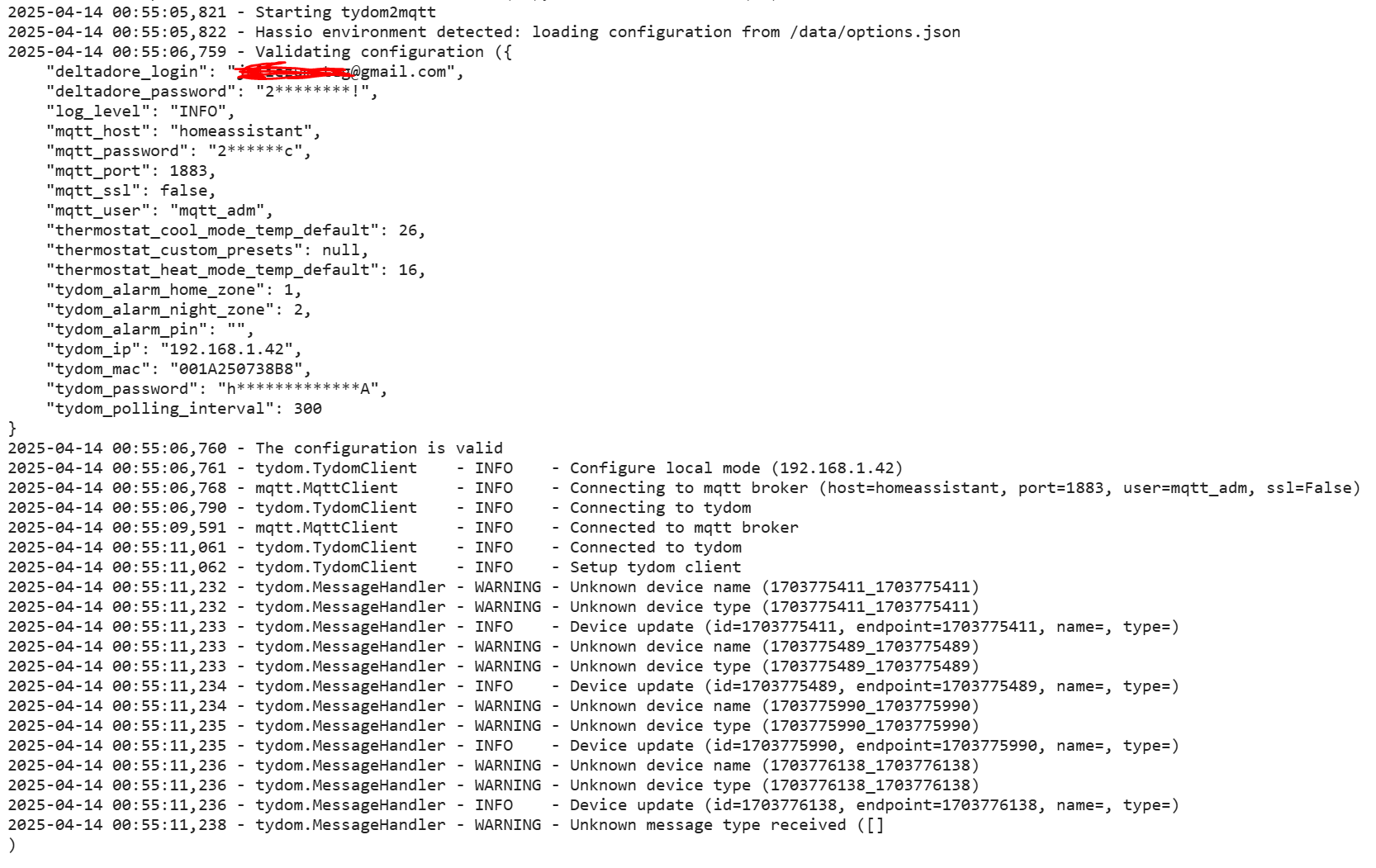

Hello !
I have exactly the same problem with Rothelec heaters, did you find a solution ?
here are my logs
Same problem here since several months / years.

Hi, I’m new to home assistant.
I’ve installed the mosquito add-on and the tydom2mqtt add-on.
The configuration seems to be ok as my DELTA DORE shutters commands (TYXIA 5630 and 5730), the garage door shutter command (TYXIA 4620) and the alarm (CS8000 TYXAL+) are all detected and configurable in Home Assistant.
However, all my door detectors (MDO TYXAL+) and my indoor movement detectors (DMB & DMBV TYXAL+) and outdoor (OPTEX BSX-R & VSX-R) are not detected by the plugin.
I’ve seen in this post that some of you managed to get their doors detectors appearing in HA.
Somebody can help me fix this?
Thanks.
