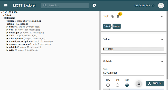

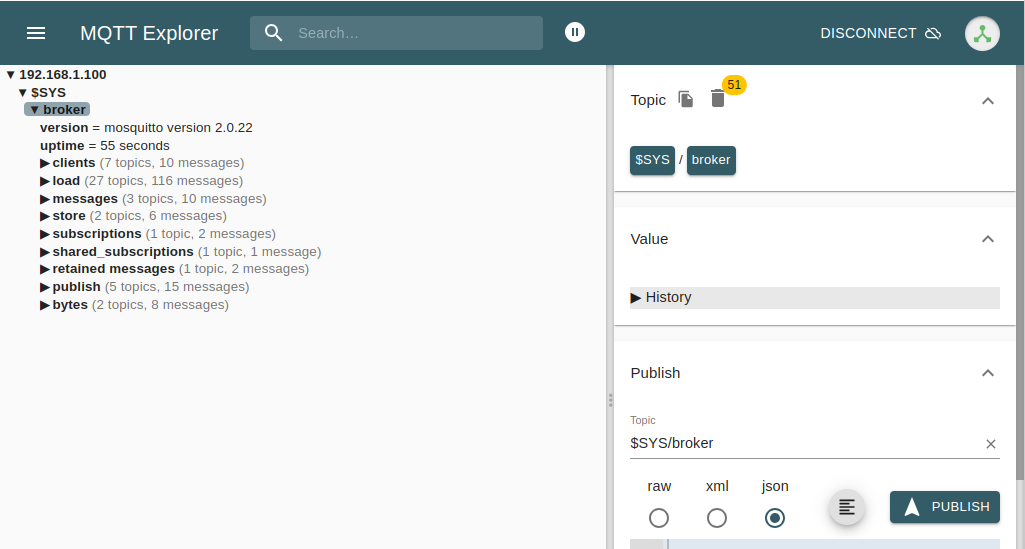

When looking at MQTT explorer, I do not see anything.

  1. I used, on my computer, the mqtt explorer to connect on mosquitto:
  2. I add a look at the mosquitto log file. I got the 2 following lines:
1754152009: New connection from 192.168.1.110:36156 on port 1883.
1754152009: New client connected from 192.168.1.110:36156 as mqtt-explorer-93c34a6a (p2, c1, k60, u'mqtt-user').
Out of this exercise, my conclusion is that the mosquitto docker seems to work properly…
