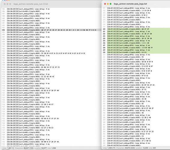

I have a custom component, that was working fine up until 2025.7.0.
It relies on time delimited data coming in from the serial/UART, and I used to be able to just grab the data ready on a run loop iteration as one packet. Now there seems to be a long delay with data trickling through.

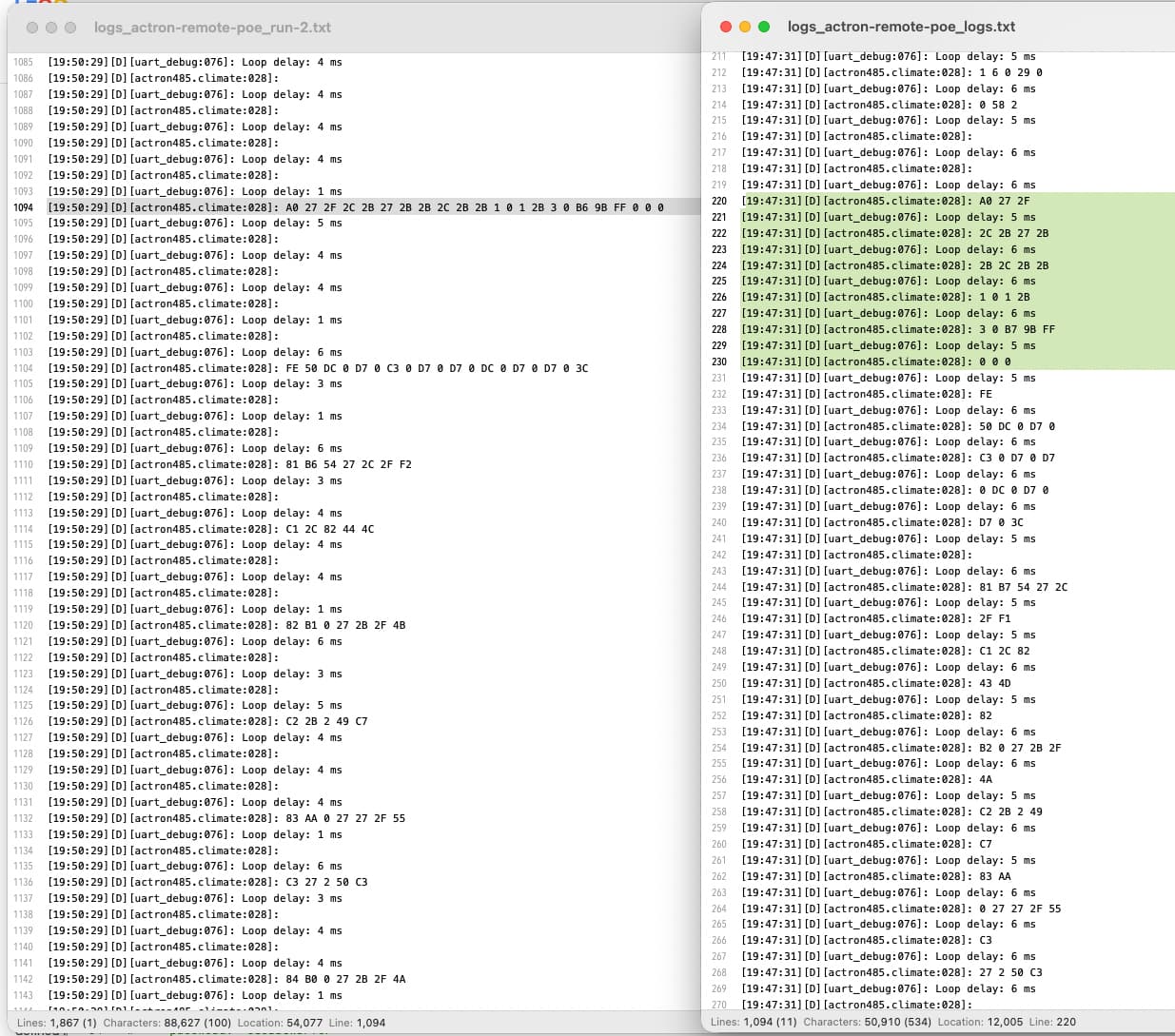

Here is a screen shot of the difference in the logs of how the serial is read, with everything else disabled and just printing the output on the serial. Left being 2025.6 right being 2025.7.2. For this example I have done this in a periodic task to go as quick as possible. Initialised under setup() in the custom component, and the actual loop() doing nothing.

At 4800 baud it takes around 2ms per byte, so getting 3 bytes per 6ms loop call is expected. You will need to wait longer if you want all the data to be buffered, but what you should be doing is fetching data one byte at a time and storing in a local buffer until you determine that an entire message has been received.
Thanks for pointing that out. So it seems in 2025.7 is coming through at rate that is expected, rather than bunched up. The code already keeps a local buffer to do this. Which was necessary when running standalone in PlatformIO polling at much faster rates. It seems as I added ESPHome support, didn’t realise the data all bunched up per loop. Once there is a minimum 5ms gap in data received it would count that as the end of the packet.
I guess I need to figure out a way to measure the time differences between the data coming in and the polling speeds attainable in ESPHome. Maybe by calculating the average of data coming in per loop and the time difference per loop. Unless there is something like an interrupt on serial bytes coming in? Or a faster way to poll?
