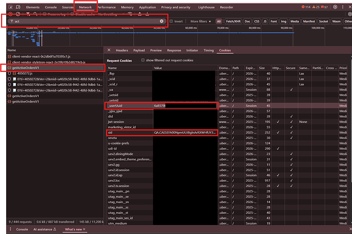

If anyone is having issues setting up the integration please follow these refined steps, its super easy. The integration has been working since day one. If you dont see any update to the order sensors 15 seconds after placing your order then you need to update the integration & or double check that your UUID & SID are up to date as uber refreshes those every few months.
Getting UUID & SID
  1. Log into www.ubereats.com in a web browser (e.g., Chrome).
  2. Open Developer Tools (F12 or right-click > Inspect).
  3. Go to the “Network” tab > “Storage” > “Cookies” > “https://www.ubereats.com”.
  4. Find the “sid” cookie and copy its value (long string, e.g., starting with “QA.CAESEF…”).
  5. Find the “_userUuid” and copy its value

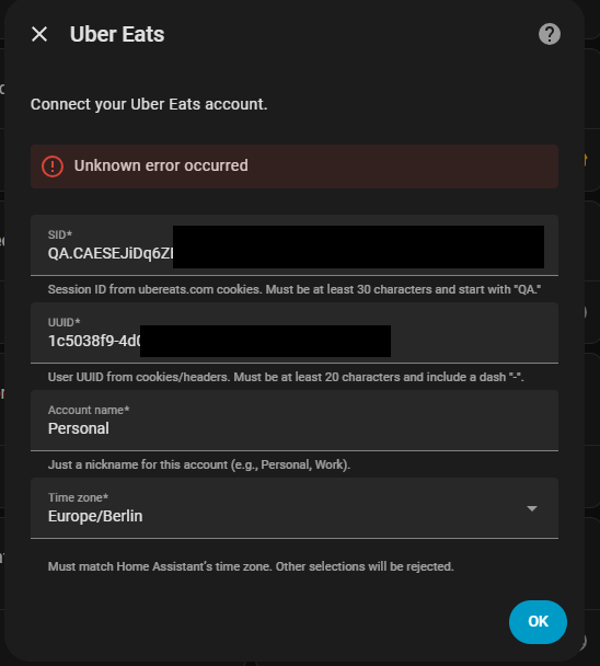

Hi I would love to integrate this into my setup but I get an “unknown error” - the format of the sid and Uuid seems to be correct
Where can I have a look on what the error might be?
upload system logs also post it on the get hub repo as an issue not on here
I dont have a _userUuid - but sid :octopus:
Okay sounds odd, i need more information:
are you using chrome via desktop?
can you provide screenshot (be sure to edit screenshot covering sensitive information)
Edit:
I just ran through the setup instructions and there still accurate, i see the both fields needed to setup, uber eats has not changed their api structure so i advise you upload screenshots of what your seeing
Hold on, I think I need new glasses. I could swear there was no UUID there yesterday. However, I am now getting the error “Unknown Error occurred.” Attached are pictures of the situation.
Okay im fixing it now
integration fixed
Thanks worked :slight_smile:

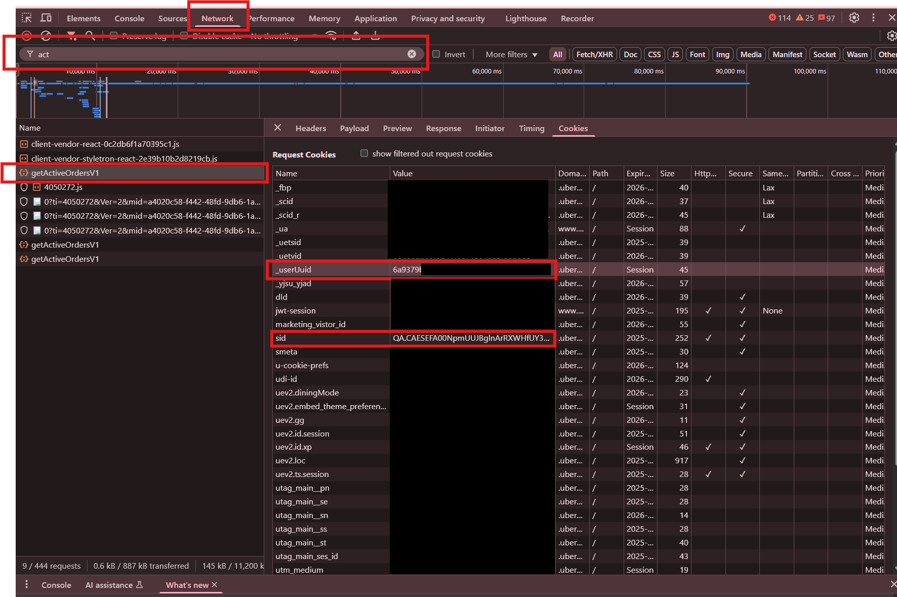

Any other way to obtain the uuid? i dont get it with chrome and firefox, it just never appears
On the get up repo upload a screenshot of where your looking
I used the value of uev2.id.session and it seems to work. (using Google as an IDP)
Thanks, i was waiting till weekend to take a look but this does help, also so gems like this dont get lost its best to open issue in the github repo :slight_smile:

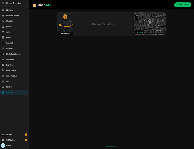

Updated Uber Eats Intergration
Tons of new features including device tracker for driver so you can add the driver location to a map on your custom dashbaords, or you can use the new intergration panel :slight_smile:
