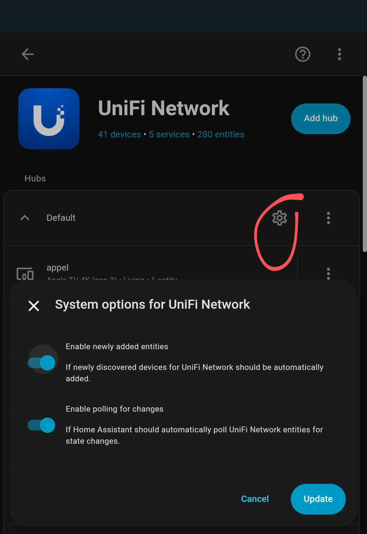

i have a bit trouble with the Ubiquiti Network integration. if i add it it connected as expected it starts with around 1k enterties. after one ore two days i have more than 17k enterties and that will break down my system. i only need like 100 enterties to device track with this integration. how can i archiv this? can i do it manual via config file? thanks in advanced. kind regards matze

To your question: if you already have all information that you require, you can edit the following setting in the Unifi Integration:

So when I change both toggles no new enterties will appear and everything continues working?

Yes it should
When you change the first toggle: the integration will stop creating new entities
When you change the second toggle: the integration will stop updating the entities that already exist.
With this setting it creates more and more devices an ha becomes unresponsive. Over night I have more than 1k devices added. They are disabled but if you go to device enterties it will load very very long.
Yes, I apologize, that is the expected behavior.
The integration will continue to discover new devices but the new ones will be disabled by default.
