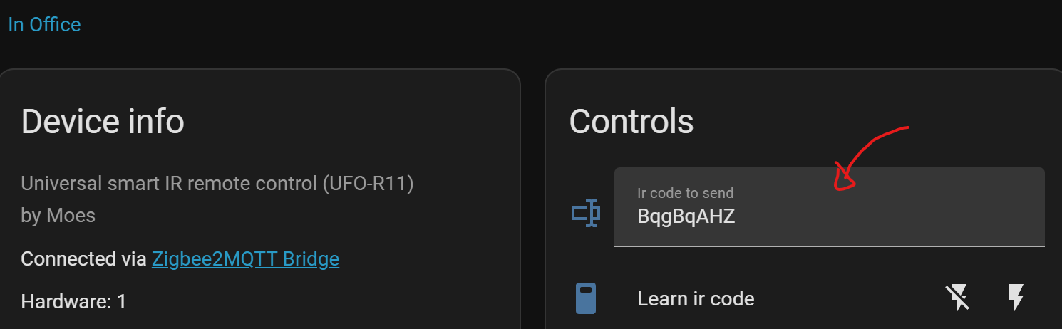

In HA, I see the device (via MQTT integration), I see the learned_code but setting “CODE_TO_SEND” does nothing. The device doesn’t send anything. It only works one way so to speak. It will enter learn mode and will display the code I teach it, but won’t send.

Maybe I misspoke. It works with mosquitto_pub, it didn’t work with HA “set text”. I did the script and replaced device set text with mqtt topic and it works. I have marked this as solved, and I hope to eventually understand why SetText doesn’t work (aka via UI).
Ohhh… yea, maybe I misread that last comment. In any regard, that is weird. I just tested my ir_code_to_send input_text entity and it works with no issue.
If I put a code in the text field and hit “enter” on my keyboard, the command works. I can’t repeat the send though. I have to clear the text field out, hit enter, paste the code again, and hit enter. I can run different codes back-to-back though.
