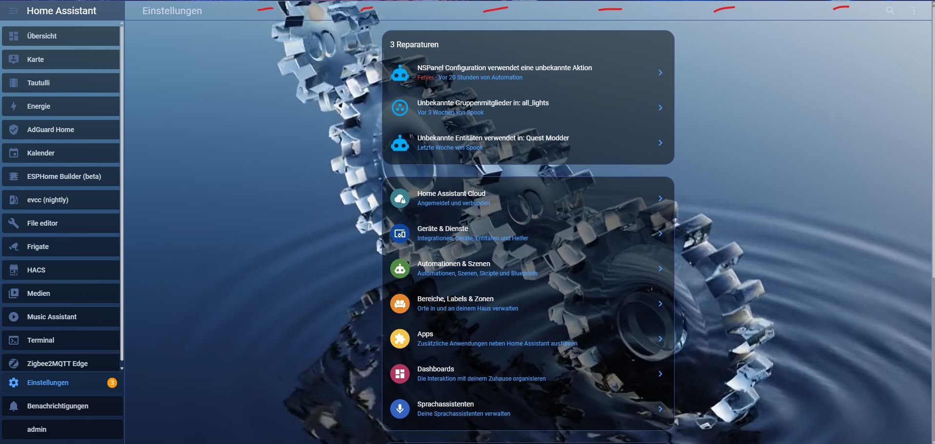

Sorry to go on your nerves again… I found a little problem I tried to fix with way too many variants of :. :host and somethings with $: and still…
Out of whatever reason this one is not colored anymore. The theme did not change since 2 days ago and this one was there from beginning as it seems… I know its in here:
document.querySelector(ā€œbody > home-assistantā€).shadowRoot.querySelector(ā€œhome-assistant-mainā€).shadowRoot.querySelector(ā€œha-drawer > partial-panel-resolver > ha-panel-config > ha-config-dashboardā€).shadowRoot.querySelector(ā€œha-top-app-bar-fixedā€).shadowRoot.querySelector(ā€œheaderā€)
and as such I tried stuff like this:
  uix-top-app-bar-fixed: |
    :host {
        background-color: "rgba(20, 26, 50, 0.58)" !important;
    :header {
And many more… all of them do absolutely nothing though. What is the right way to go here?
    :host {
        --app-header-background-color: rgba(20, 26, 50, 0.58) !important;
or
    :host header {
It does not change anything here… I wonder why though. It’s as always… I have a variable in dev console and switching it off does change the part I wanna change. But whatever I/we try does not even show up anywhere. I did update the themes via action, refreshed and even chnaged the theme a bit around. Nothing changes.
Sorry, that’s the wrong selector. The correct one is this.
2026-04-10 14.10.57
I think we are talking about something different here? I am talking about the completely transparent top bar i put some red lines into in my image. Nothing changes there with your code and… what is this &config_header ?
this var --app-header-background-color It’s used for the header’s background-color, specifically for the entire top bar. As you can see in my screenshot, it’s transparent, I just added a blur backdrop-filter.
Yeah I know that it’s for that. I am just wondering why nothing really seems to reach it in my theme. Maybe I am killing the result with my other stuff?
app-header-background-color: 'transparent
This is a ā€œmain-themeā€ color , no need for uix
For other items in Main-Header use ā€œrootā€
uix-root: |
    .header .toolbar .action-items {
      display: none;
    .header .toolbar .main-title {
      display: none;
      display: flex;
      flex-grow: 1;
      flex-direction: row-reverse;
OK, I think I found the culprit. At least now the config page has a top bar again. Now lets see if I can use that new knowledge for the others like cloud config page etc. If I do I will of course tell you what stupidity was the problem ^^
@boheme61 I know that color. It’s declared as a color in my theme, but something decided to overwrite it with transparent.

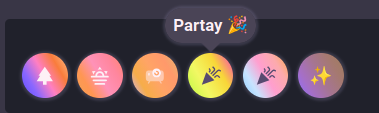

I’m gonna put some tooltips everywhere now ! :smiley:

So my final working is using badges to show some scene (actually script) I use !
type: custom:auto-entities
filter:
  include:
    - options:
        type: custom:uix-forge
        forge:
          mold: badge
          sparks:
            - type: tooltip
              for: hui-entity-badge $ ha-badge
              content: <b>{{state_attr(config.element.entity, 'friendly_name')}}</b>
        element:
          type: custom:hui-entity-badge
          show_name: false
          show_state: false
          show_icon: true
          entity: this.entity_id
          tap_action:
            action: perform-action
            perform_action: this.entity_id
            target: {}
              where_to: Grand PiĆØce
              transition: 0
          uix:
            style:
              ha-badge $: |
                .badge {
                    --ha-badge-size: 38px;
                    --ha-badge-border-radius: 50%;
                    background: {{state_attr(config.entity, 'gradient')}} !important;
                    --badge-color: {{state_attr(config.entity, 'text_color')}};
      domain: script
      label:
        label: scene_other
        active_choice: label
      sort:
        method: friendly_name
  exclude:
    - options: {}
      label:
        custom: Hidden
        active_choice: custom
    - options: {}
      hidden_by: user
    - options: {}
      label:
        label: lights_24h_scene
show_empty: true
card_param: badges
card:
  type: custom:badge-horizontal-container-card
  badges_wrap: wrap
  badges_align: left
  uix:
    style: |
      .badges {
        margin-top: 16px !important;
sort:
  reverse: false
grid_options:
  columns: 24
  rows: auto
