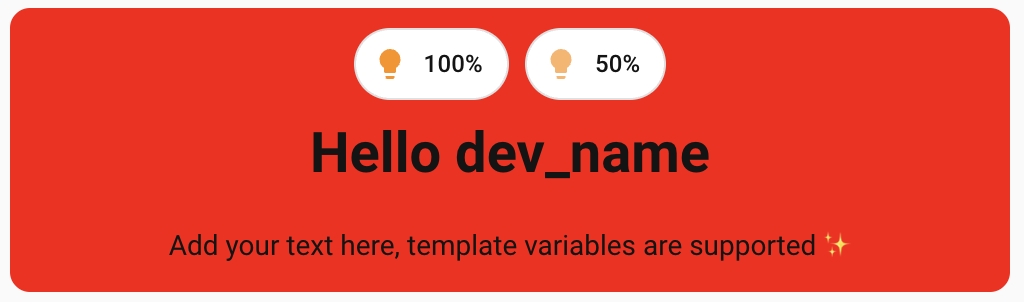

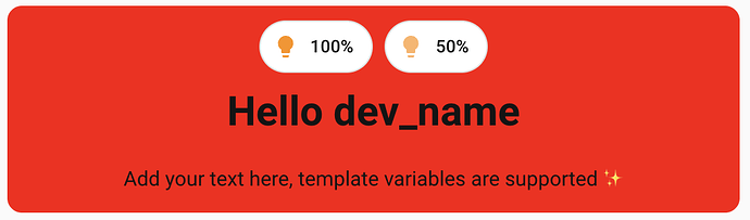

Option 2: uix-forge with background spark as a heading card
This opens up lots of possilities with the uix-forge background spark. Basically use uix-forge as the heading card. If you need more than one card or need badges, then use a vertical-stack, and for badges then contain them in custom:badge-horizontal-container-card. The background spark has no heading adapter (like it does for ha-card and hui-grid-section) so you will need to style the border of the background and perhaps add some padding the vertical stack to your liking.
Heading card yaml... Edited updating to match doc example
type: custom:uix-forge
forge:
  mold: card
  sparks:
    - type: background
      for: "hui-vertical-stack-card $ #root"
      # camera_entity: camera.front_door
      # image_entity: person.dev
      # video_url: https://some.video.url/video.mp4 or media_source
      # image_url: https://some.imaghe.url/image.png or media_source
      background: red
      class: my-heading-bg
element:
  type: vertical-stack
  cards:
    - type: custom:badge-horizontal-container-card
      badges:
        - entity: light.bed_light
        - entity: light.kitchen_lights
    - type: markdown
      content: |-
        # Hello {{ user }}
        Add your text here, template variables are supported ✨
      text_only: true
  uix:
    style: |
      .my-heading-bg {
        border-radius: var(--ha-card-border-radius, var(--ha-border-radius-lg));;
      #root {
        padding: 10px;

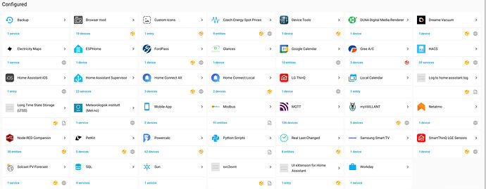

Have you noticed no icon for the UIX integration?
A few weeks ago, I noticed that the icon is missing from HA Settings/repair notifications.
Darryn answered that it's an HACS issue.
But now I can see the icon is not shown in multiple places. At the same time other custom integrations installed with HACS provide their icons.
Is it really HACS issue, or something that could be verified within UIX?
With regards
Yes. Still an issue for HACS to solve. The icons you do see are those that are in the Home Assistant Brands repository before that was closed in preference of integrations proving icons natively. HACS is still using old Frontend code which relies only Brand repository only and does not use the update native Home Assistant.
In summary any integration that has not been able to be added to Brands repository will not be shown in any area where the display is being generated by HACS which includes repairs and update sensors it creates.
I hope that it clears it up for you.

The icon will show in Home Assistant Devices & sevices and Integration page. It just won't show in HACS generated pages/notifications.
Hmm. As you can see on the screenshot attached to my previous post, the icon is missing on Devices&Services page too. TBH I never seen it in my system. Only on some screenshot

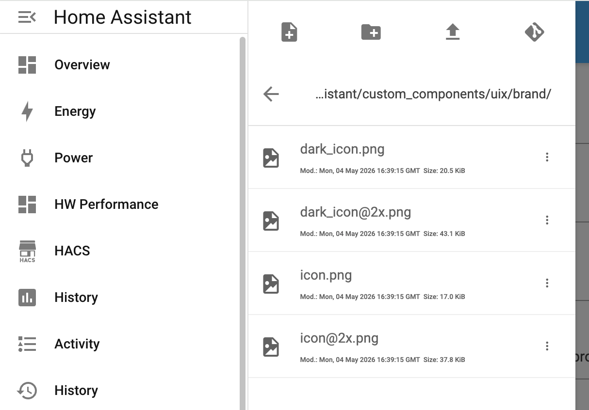

Check if you have the icons in custom_components/uix/brand. If yes, then you not sure - perhaps caching issue :man_shrugging: . If no icons, then try redownloaing UIX.
Also, your screenshot shows a Configured title - not sure where that is. Can you confirm what settings page that is?
Yes. I have uix/brand
The previous screenshot shows a selected part of the common Settings / Devices&Services / Integrations page.
