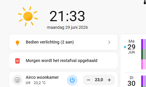

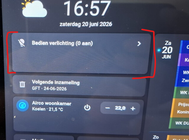

Hope there are some smart people around here to help me with the following.
I use uix to "add an extra button" to a mushroom card:
type: "custom:vertical-stack-in-card"
uix:
  style: |
    ha-card { height: 55px !important; }
cards:
    primary: >-
      {% set light_count = (expand(state_attr('light.verlichting_voor_gebruik_op_kiosk', 'entity_id')) |
          selectattr('state','eq','on') | list | count) %}
      Bedien verlichting ({{ light_count }} aan)
    icon: |-
      {{ "mdi:lightbulb-on" if is_state('light.verlichting_voor_gebruik_op_kiosk', 'on') else "mdi:lightbulb-off" }}
    icon_color: |-
      {{ "orange" if is_state('light.verlichting_voor_gebruik_op_kiosk', 'on') else "grey" }}
    uix:
      style: |
        ha-state-icon {
          {{ "animation: illumination 3s infinite;" if is_state('light.verlichting_voor_gebruik_op_kiosk', 'on') }}
    hold_action: none
    tap_action: &light_popup
      action: fire-dom-event
      browser_mod:
        service: browser_mod.popup
          title: Verlichting
          timeout: 20000
          content:
            type: vertical-stack
            cards:
               <<snip not relevant code block>>
    icon: mdi:chevron-right
    uix:
      style:
          ha-card {
            background: none;
            margin-left: 310px;
            top: -54px;
            width: 40px;
    tap_action: *light_popup
Sometimes the cards don't overlap/shrink properly:
Expected behavior, observed 80% of times (this time in light mode, mode does not make a difference):
Any ideas?
edit:
Same applies to the airco card, as you can see in both screenshots above.

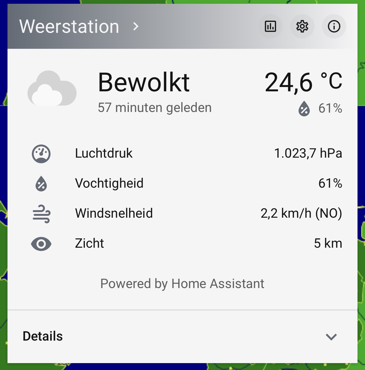

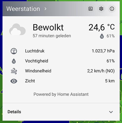

Yeey, already used to having those buttons in the heading directly going to individual more-info views
And the more-info of the weather itself of course.
Super functionally!
include_weerstation_more-info
# include_weerstation_more-info
# use UIX spark to directly open on more-info
# see https://uix.lf.technology/forge/sparks/more-info/
# contain in vertical-stack and add type: heading for clickable actions
# additionally add buttons with uix action to replicate more-info action
uix: !include /config/dashboard/uix_mods/stack_card_gap_shadow.yaml
cards:
  - type: heading
    uix:
      class: class-heading
    heading: Weerstation
    tap_action:
      action: more-info
      entity: weather.weer_station
    badges:
      - type: button
        icon: mdi:chart-box-outline
        tap_action:
          uix:
            action: more-info
              entityId: weather.weer_station
              view: history
      - type: button
        icon: mdi:cog-outline
        tap_action:
          uix:
            action: more-info
              view: settings
      - type: button
        icon: mdi:information-outline
        tap_action:
          uix:
            action: more-info
              view: related
#       - type: button
#         entity: weather.weer_station
#         icon: mdi:cog-outline
#         tap_action:
#           action: more-info
  - type: custom:uix-forge
    forge:
      mold: card
      sparks:
        - type: more-info
          details: true
# instead of element here, use heading in vertical-stack
#     element:
#       title: Weerstation
#       uix: !include /config/dashboard/uix_mods/card-header-forge.yaml
# for reference: actions not directly available on spark
#       tap_action:
#         action: more-info
