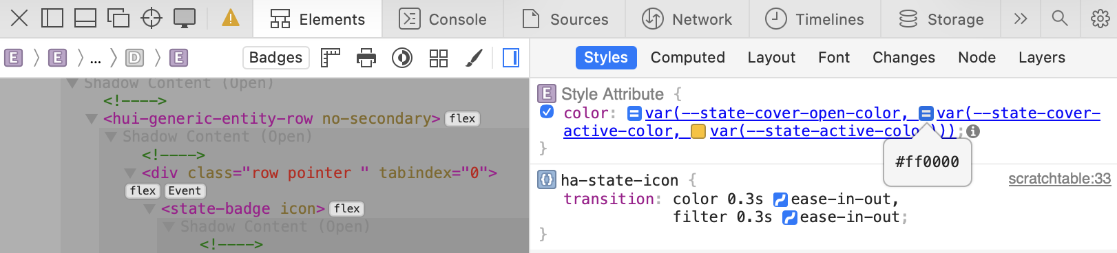

Chrome inspector bug. Safari shows correctly - a rare win for Safari :rofl:
I note Chrome shows correctly on Computed tab.
Wow. Thank you. Didn’t expect that, because the purple is the HA default and I wouldn’t understand, from where the expector gets that if set differently in theme.

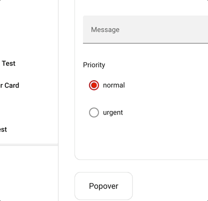

Form spark also in the works to complement this so you can Forge a form on a popover
Form on Forged element in popover - sneak peak
Oct-02-2026 21-52-31

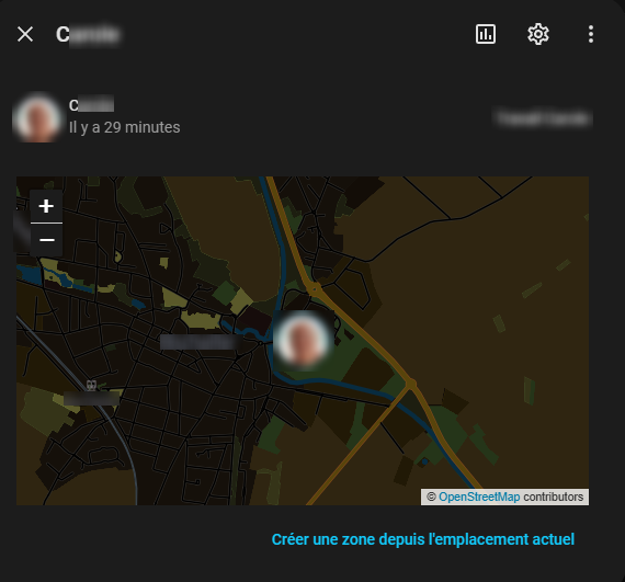

I’m using my customized theme in dark mode.
Since a few HA versions, map cards in dark mode are realy realy dark and with uncontrasted colors (my opinion).
Is there a way to force all the UI map cards in light mode (especialy when showing the user more info panel) ?
Yes, with UIX Broker. See below…
First to mention that for map cards you can set directly, including a new user style available in 2026.10.0b0. The PR that enabled the user style also enabled style tokens, but you would need to research more for what a light style uses and then set them directly. See the PR for more info including the bit on —ha-color-map-* tokens.
The UIX Broker way is to directly set theme mode and style on all map cards and more-info containing maps. Use the following 2 interactions.
These are adapted for what I supplied to @Mariusthvdb who also uses a JavaScript directive first to set a theme mode.
The first interaction works to set theme mode and style on map card (hui-map-card), which also has buttons outside ha-map which are either white or black based on theme mode.
The second interaction works to set theme mode on ha-map used in more-info and acts directly on ha-map.
  - realm: browser
    listen:
      - uix-applied
      - uix-theme-update
    anchor: "hui-map-card <$$ target"
    reentrant: false
    rules:
      - hui-map-card
    directives:
      - type: property
        set: _config.theme_mode
        value: "light” # or dark
      - type: property
        set: _config.map_style
        value: "toner" # see map card doco for styles
      - type: call
        rules:
          - "{.requestUpdate}"
        method: "requestUpdate"
        args:
          - "hass"
  - realm: browser
    reentrant: false
    listen:
      - uix-applied
      - uix-theme-update
    anchor: "<$ target"
    rules:
      - ha-more-info-dialog
    directives:
      - type: property
        anchor: "$ ha-more-info-info $$ ha-map"
        set: themeMode
        value: "light"
      - type: property
        set: mapStyle
        value: "toner"
As of 2026.10 you can set new Map theme tokens for many individual map properties
Have a look a that, you might be able to do natively in Frontend, and not use UIX for that

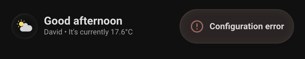

So I finally made the switch to UIX and 99% of my dashboard was unaffected!
I can’t figure out how to fix this part though which uses “custom:mod-card”, that is the only thing that broke for me
Not gonna share the full code only the part thats broken cuz AI hasn’t been helpful lol

Does the error show anything more in edit mode?
Nope, maybe it was a cache issue cuz strangley I just noticed it is working now randomly. If it breaks again I’ll tell you but the editor was actually just blank for this card only when it was broken btw.
