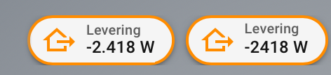

figured I’d share this, a nice improvement of my energy view
with a little (…) help I managed to set a mod on a regular badge and replace the fixed name for a templated name. Since that is the whole and sole reason I had Mushroom installed, I can now delete that.
Only difference left between the regular (on the left) and the mushroom-template (on the right) is the thousand indicator
uix:
  style:
      :host {
        {% set netto = states(config.entity)|float(0) >= 0 %}
        {% set color = 'brown' if netto else 'var(--power-color)' %}
        --ha-card-border-width: 2px;
        --ha-card-border-color: {{color}};
        --ha-card-box-shadow: var(--box-shadow-badges);
      ha-state-icon {
        color: {{'brown' if netto else 'var(--power-color)'}};
        --uix-icon:
          mdi:home-{{'import' if netto else 'export'}}-outline
    ha-badge $: |
      .info:before {
        content: '{{'Verbruik' if netto else 'Levering'}}';
        color: var(--secondary-text-color);
        font-size: 10px;
        font-style: normal;
        font-weight: 500;
        line-height: 10px;
        letter-spacing: 0.1px;
