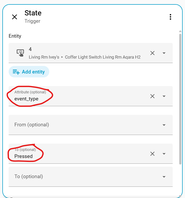

UI Not Triggering Automation with Physical Button Press
Does anyone know why this part of the UI will not trigger an automation with a button press. I have not seen a use case where it has a function. Triggering an automation with a button press is basic therefore i would think it should be streamlined.
It will only trigger when the attribute value changes. So, if you press the button once when the value of event_type isn’t “Pressed”, it will trigger. Then when you press it again the attribute value hasn’t changed, so it doesn’t trigger.
Use the State trigger without the attribute or to defined, this will cause the trigger to fire every time the button is pressed. Then use a condition to check that it’s the desired attribute value before proceeding to execute the action sequence.
That makes perfect sense now.
Regarding:
“Then use a State condition to check that it’s the desired attribute value before proceding to execute the action sequence.”
I assume you do this in the “and if” part of the automation? How would i start that? I have had issues with these physical button triggering at night with the HA restarts haha
Yes, “And If” is formally known as the Conditions block of the automation.
You actually have two options. The best option is to use a Template condition so that you know you are checking the same value that triggered the automation in the first place:
condition: template
value_template: "{{ trigger.to_state.attributes.event_type == 'Pressed' }}"

Your automation triggered after the restart because the state of the event is unavailable immediately upon restart, and then shortly thereafter it restores to its previous state, which for an event is the timestamp of the last occurrence. So, shortly after restarting, the state changed from unavailable to 2025-12-14T15:13:13.518+00:00. That caused your automation to trigger.
The change that will guard against that is modifying your trigger to include the not_from as Drew mentioned:
trigger: state
entity_id: event.YOUR_ENTITY
not_from:
  - unknown
  - unavailable
The condition is what you need to ensure your automation only continues if the event type was Pressed. You can use the template condition or the state condition for that. As Drew said, the template condition is the preferred one because it looks at the event that triggered the automation. The state condition instead looks at the event at that moment, and it’s possible (although unlikely) that the event has changed since the automation was triggered a fraction of a second ago.
Thanks.
When I use the template Condition and click on the “test” I don’t get the usual Condition Passes or condition did not pass. It does nothing. Is this expected?
The trigger variable isn’t defined until the automation is triggered. So when you test the condition manually, it’s going to error out.
If you want to test an automation that references a trigger variable, you’ll need to actually trigger it. Since you have a state trigger, you can trigger it by changing the state of that event entity in developer tools → state.
