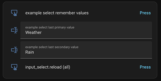

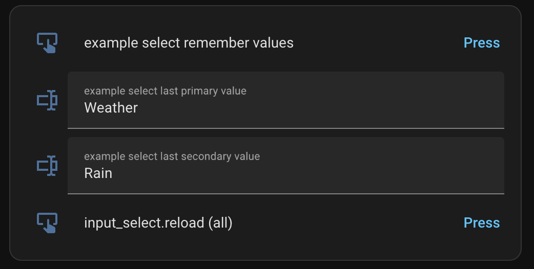

So, what I do is save the current input_selects’ states into two input_text entities for restoring later.
Then I can save the current selects:
When I press that bottom button it calls input_select.reload to emulate a HA restart, and then I populate the options and finally update the input_selects’ state from the saved input_text entities.

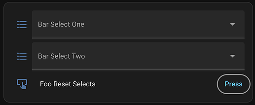

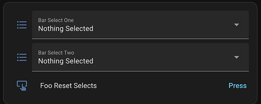

The UI issue

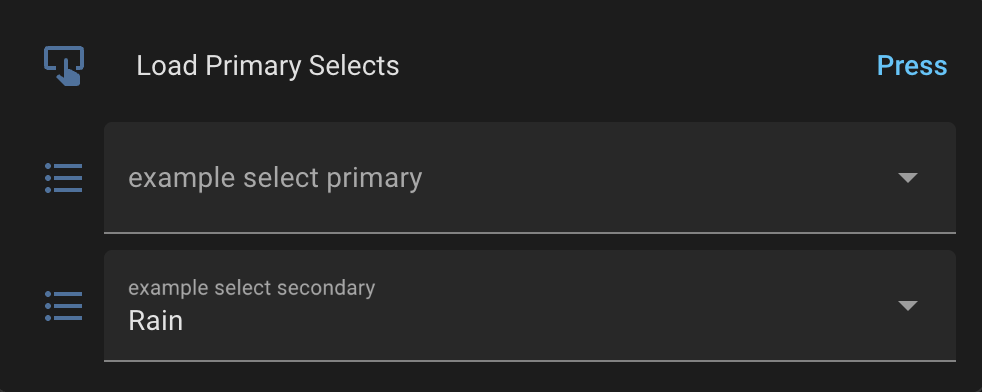

But often what happens is the UI will then show this where one (or the other) doesn’t show the actual current state – but I know the state is set.
It varies which select doesn’t update in the UI.
The input_selects do get their state updated, though. Refreshing or changing tabs will update the UI. Same behavior in Chrome and Safari.

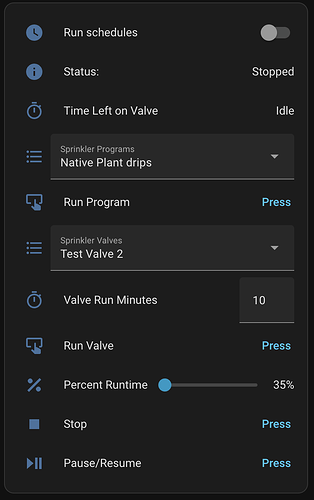

Here’s where I am right now with very little styling, if curious.

Ok, here’s a much simpler example that shows how the UI fails to update.
Maybe it’s not an HA-specific issue, but the javascript library not updating the “select”. Because I can see HA send the updated select value via the websocket, but it just doesn’t show up in the UI.
Update: that said, if you remove the input_select.reload the UI updates. So, maybe a timing issue – although a delay doesn’t fix.
  1. create a input_button helper
  2. create two input_selects.
    They have to be in YAML not in the helper UI because input_selcte.reload only reloads the YAML ones.
    (input_select.reload is simply to avoid having to restart HA core.)

And when I press “Foo Reset Selects” the UI doesn’t refresh:
But my logs (or Debug->States) show that the state (and options) are indeed updated.
2025-11-06 11:48:36.891 ERROR (MainThread) [homeassistant.components.system_log.external] input_select-two
state="Three"
options="Nothing Selected, Three, Four, Five]"
2025-11-06 11:48:36.894 ERROR (MainThread) [homeassistant.components.system_log.external] input_select-one
state="Seven"
options="[Nothing Selected, Six, Seven, Eight]"
