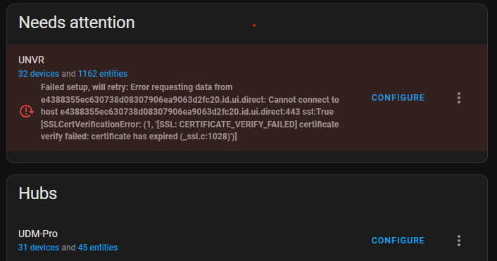

After upgrading to the latest release of HA (version 2015.6.1) my UI Protect integration keeps throwing error notices:
I’ve tried reloading and even went as far as going back to a prior build, but without any joy!
Any thoughts or suggestions?
all good here, using UNVR and HA Core 2025.6.1.
Error suggests issue with SSL certificate. Is date on your HA installation correct? is certificate on your UNVR valid (probably self signed, but is it valid?)
@tmcgowan Did you ever figure out how to cause the UNVR to renews it’s id.ui.direct CERT? Mine just expired yesterday and now I’m having this same issue. Restarting the UNVR didn’t cause a new CERT to be issued. :frowning:
