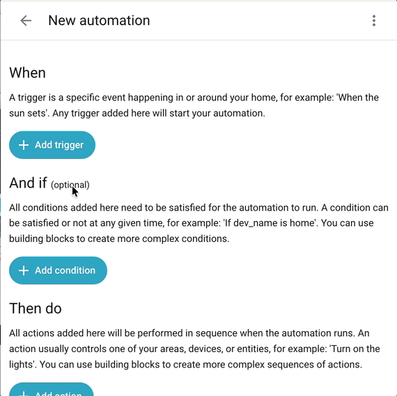

Automation sidebar and YAML mode complete
uix_broker:
  - realm: browser
    listen: open-sidebar
    reentrant: false
    anchor: manual-automation-editor <$$ target
    rules:
      - '{!.uixBlockAutoYamlMode}'
      - anchor: $ ha-automation-sidebar $$ ha-automation-sidebar-card
        match: '{.yamlMode=false}'
    directives:
        method: _toggleYamlMode
        type: call
      - type: button
        before: $ ha-automation-sidebar $$ ha-automation-sidebar-card $ ha-dialog-header slot:nth-of-type(3) ha-dropdown
        icon: mdi:code-braces
        tap_action:
          action: fire-dom-event
          uix:
            action: event
  - realm: browser
    listen: toggle-yaml-mode
    directives:
      - type: block
      - type: property
        set: uixBlockAutoYamlMode
        value: true
        type: call
      - type: property
        clear: uixBlockAutoYamlMode
  - realm: shortcut
    enabled: true
    listen: $mod+Shift+Y
    anchor: '&home-assistant $$ manual-automation-editor'
    directives:
      - type: property
        value: true
        type: call
      - type: property
Sep-01-2026 13-32-56

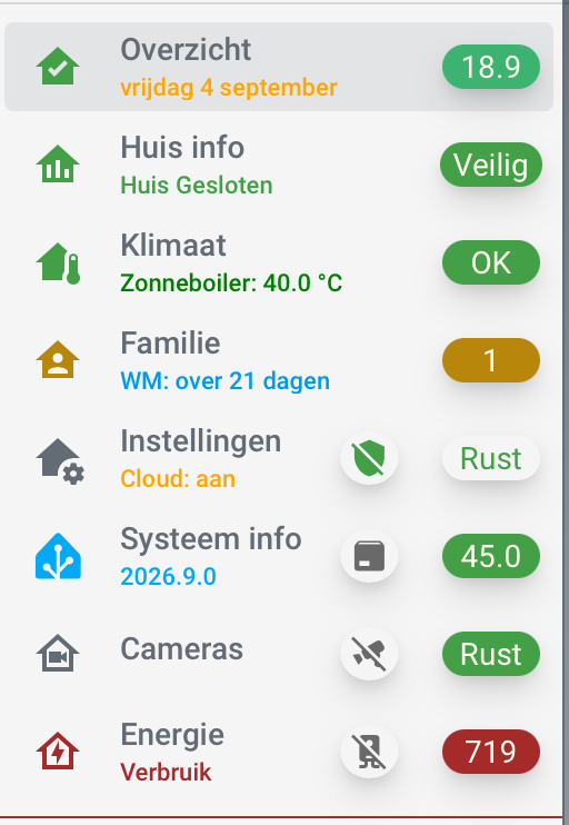

had a bit of fun with the new possibilities of uix_broker and enhanced my sidebar a bit… (note the notification badges are made in custom-sidebar)
uix_broker_sidebar
# uix_broker_sidebar.yaml
# https://uix.lf.technology/broker/examples/
uix_broker:
  - realm: server
    listen: state_changed
    anchor: "&home-assistant"
#     debug: true
    rules:
      - type: captured
        path: data.entity_id
        match:
          or:
            - switch.cameras
            - switch.security_system
            - switch.opentherm_dhw_comfort_mode
            - binary_sensor.update_beschikbaar
    directives:
      - type: event
  - realm: browser
    listen:
      - uix-broker-ready
      - uix-update-sidebar
    anchor: "&home-assistant $ home-assistant-main $ ha-sidebar"
    debug: true
    rules:
      - anchor: "&home-assistant"
        match: "{.hass.user.is_admin=true}"
    directives:
      - type: javascript
        code: |
          const entity = 'switch.security_system';
          const state = hass.states[entity].state;
          return {
            entity: entity,
            icon: state === 'off' ? 'mdi:shield-off' : 'mdi:shield-home',
            color: state === 'off' ? 'var(--success-color)' : 'var(--error-color)'
      - type: javascript
        code: |
          const entity = 'switch.cameras';
          return {
            entity: entity,
            icon: state === 'on' ? 'mdi:cctv' : 'mdi:cctv-off',
            color: state === 'on' ? 'var(--error-color)' : 'var(--no-power-color)',
            background: state === 'on' ? 'pink' : 'black'
      - type: javascript
        code: |
          const entity = 'switch.opentherm_dhw_comfort_mode';
          return {
            entity: entity,
            icon: state === 'on' ? 'mdi:water-boiler' : 'mdi:water-boiler-off',
      - type: javascript
        code: |
          const entity = 'binary_sensor.update_beschikbaar';
          return {
            entity: entity,
            icon: state === 'on' ? 'mdi:package-up' : 'mdi:package',
            color: state === 'on' ? 'var(--ha-color)' : 'var(--no-power-color)'
      - <<: &sidebar_button
          type: button
          tap_action:
            action: toggle
          tooltip: test
          style:
            --ha-button-box-shadow: var(--ha-box-shadow-m)
            --mdc-icon-size: 18px
            --ha-icon-button-size: 24px
  #           --uix-button-margin: 6px
            --ha-button-border-radius: 50%
            transform: translateX(70%)
            margin-left: -24px
  #           border: '1px green solid'
        anchor: "$ ha-list-item-button#sidebar-panel-ui-instellingen $ a#item div.content"
        icon: "@button_beveiliging.icon"
        color: "@button_beveiliging.color"
        entity: "@button_beveiliging.entity"
#         appearance: outlined
#         variant: neutral
      - <<: *sidebar_button
        tap_action:
          confirmation:
            text: Bevestig schakeling
            confirm_text: Zonneboiler comfort-mode aan
            dismiss_text: Zonneboiler niet schakelen
        anchor: "$ ha-list-item-button#sidebar-panel-energy $ a#item div.content"
        icon: "@button_zonneboiler.icon"
        color: "@button_zonneboiler.color"
        entity: "@button_zonneboiler.entity"
        type: button
        tap_action:
          action: perform-action
          perform_action: homeassistant.update_entity
            entity_id: binary_sensor.update_beschikbaar
        anchor: "$ ha-list-item-button#sidebar-panel-ui-develop $ a#item div.content"
        icon: "@button_updates.icon"
        color: "@button_updates.color"
        entity: "@button_updates.entity"
        anchor: "$ ha-list-item-button#sidebar-panel-ui-cctv $ a#item div.content"
        icon: "@button_cameras.icon"
        color: "@button_cameras.color"
        entity: "@button_cameras.entity"

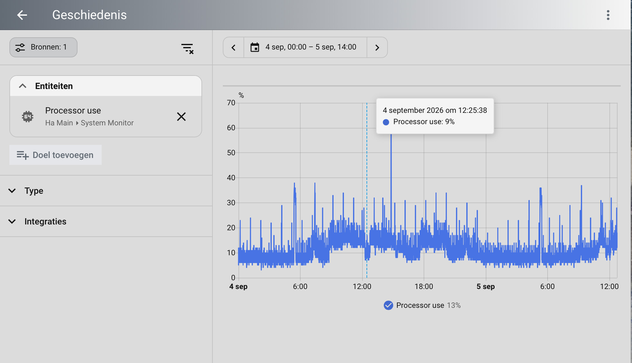

right.. so, with latest beta 15, I made this, to correct the UI showing Sources on each and every click on More in the History graphs on a more-info dialog.
I truly feel that is a UI design error, allowing my users to go into the realms of entities I dont want them to.
this prevents showing that (I still want to hide the Sources button completely, so half way there)
It opens a /history navigation completely and unchanged, if you happen to have that
# uix_broker_history_sources.yaml
uix_broker:
  - realm: browser
    listen: click
    debug: true
    anchor: "&home-assistant $ ha-more-info-dialog $ ha-more-info-info $ ha-more-info-history $ div.header a"
    directives:
      - type: property
        anchor: "&home-assistant $ home-assistant-main $ ha-drawer partial-panel-resolver ha-panel-history"
        set: _showSources
        value: false
and not

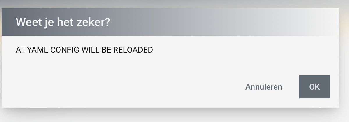

another interception I now have is a guard on the Reload All Yaml configurations, I happen to click that accidentally more than I want, and it always breaks the connection
# uix_broker_guard_yaml_reload.yaml
uix_broker:
# Config Tools Yaml confiormation for buttons
  - realm: browser
    listen:
      - uix-broker-ready
      - uix-update
    debug: true
    anchor: "&home-assistant $ home-assistant-main $ ha-panel-tools $ tools-yaml-config"
    rules:
      - type: panel
        path: fullUrlPath
        match: "config/tools/yaml"
    directives:
      - type: property
        anchor: "$ ha-call-service-button[service=reload_all]"
        set: confirmation
        value: "All YAML CONFIG WILL BE RELOADED" # a-call-service-button[ will show this text in confirmation if set
now gives me
how cool is that. no more accidents thanks to UIX-Broker!
