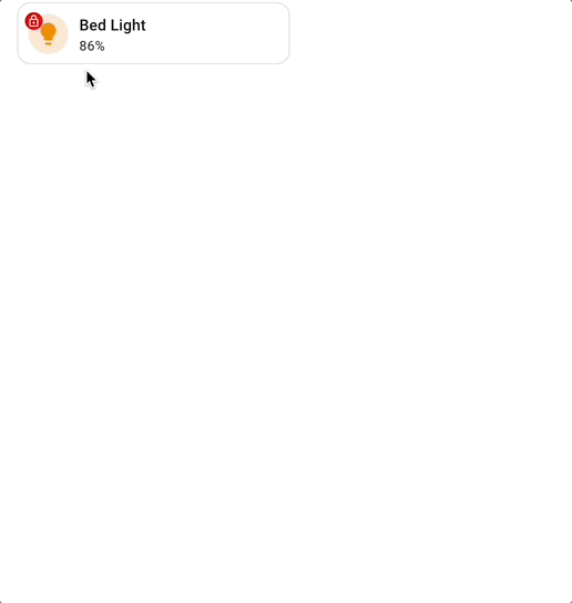

:mega: 6.2.0-beta.5 - Lock spark updates and map tour mode :mega:
Lock spark icon when target ha-tile-icon
lock-spark-styling-example-2

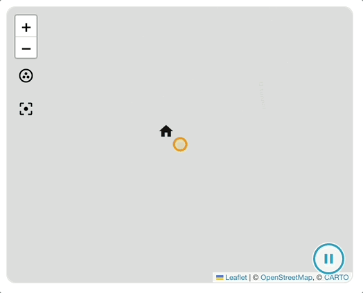

Map tour
Apr-09-2026 19-35-40

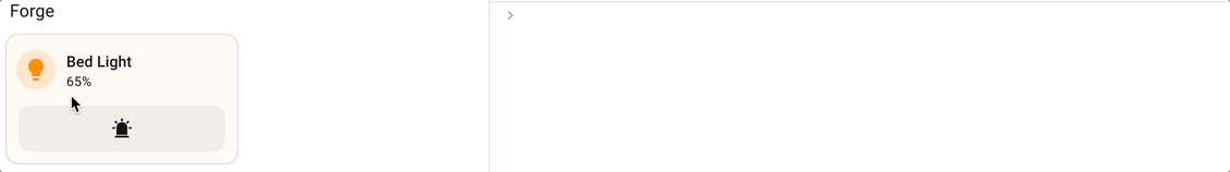

@reste_narquois v6.2.0-beta.6 available with nesting support working correctly
type: custom:uix-forge
forge:
  mold: card
element:
  type: tile
  entity: light.bed_light
  vertical: false
  features:
    - type: custom:service-call
      entries:
        - type: button
          entity_id: light.kitchen_lights
          tap_action:
            action: toggle
              entity_id: |
                << config.entity >>
            data: {}
          icon: mdi:alarm-light
  features_position: bottom
See test showing light.kitchen_lights is being actioned. My test here was pretty simple to show that the entity is coming from the custom feature button config.
Apr-10-2026 19-00-31

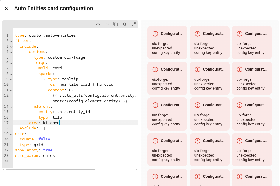

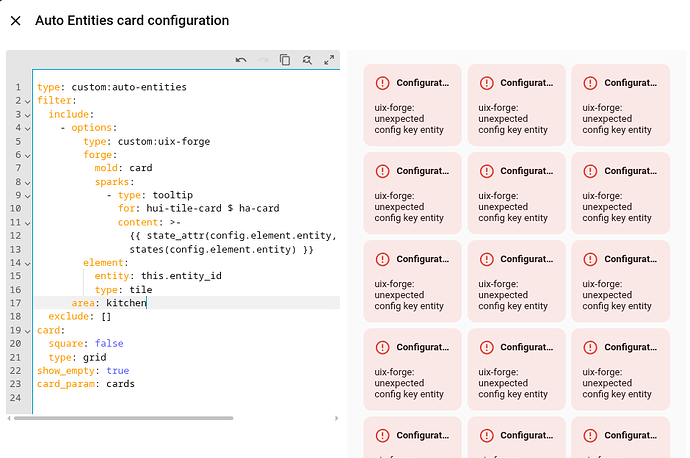

I’m trying out the auto-entities example from the UIX Forge documentation but it’s giving me an error in the rendering of the cards. This is a direct copy paste of the code. I get it for any of the defined areas that I have. I’m on the current release of uix (v6.1.0) and the new auto-entities (v2.1.0). Given that this is straight out of the documentation I would expect it to work
I tried this because my original intent, to use an entity_id with some globs instead of the area gave me the same error and I figured I should try something from the docs first
Needs latest beta.
Ok, that fixed it for me. Now to try putting together my real use case :slight_smile:

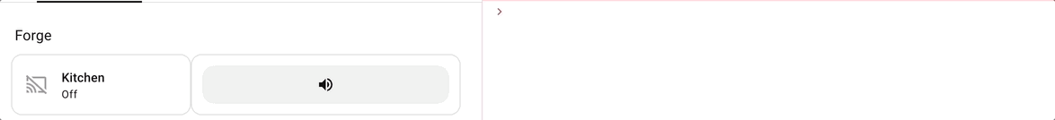

v6.2.0-beta.7 available which implements multi-level forge nesting. The syntax extends existing single level nesting in that each level gains a <> pair.
Tetsed example
forge:
  mold: card
  sparks:
    - type: grid
      for: "hui-grid-card $ #root"
      columns: 40% auto
      column_gap: 0px
element:
  type: grid
  square: false
  cards:
    - type: custom:uix-forge
      forge:
        mold: card
      element:
        type: tile
        entity: media_player.dcd_browser
      forge:
        mold: card
      element:
        type: custom:custom-features-card
        features:
            entries:
              - type: button
                entity_id: input_boolean.test_boolean
                icon: mdi:volume-high
                haptics: true
                tap_action:
                  action: perform-action
                  perform_action: input_boolean.toggle
                    entity_id: |
                      <<< config.entity >>>
Apr-11-2026 10-46-20
