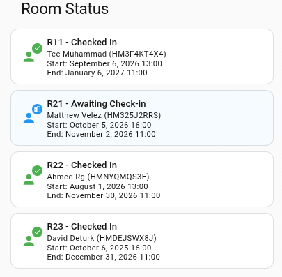

Here’s what the main dashboard (auto-guest_card forge) card looks like rendered in an HA with multiple rental listings
It was defined like this:
type: custom:uix-forge
foundry: auto-guest_card
entity: sensor.r*_check_in

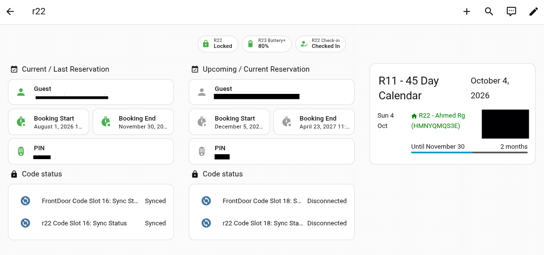

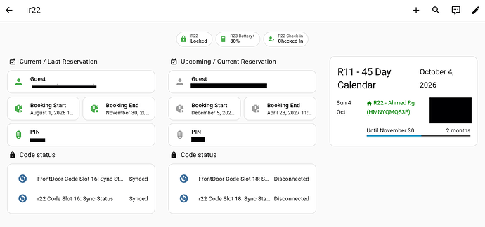

Here’s what a rendered sub-view looks like. Everything on that page could easily have been calculated from the sub-view path which came from the auto-guest_card on the main dashboard
. The Current and upcoming sections are the current_guest forge that I only had to stick on variable into.
They were both defined as:
foundry: current_guest
entity: sensor.rental_control_r22_event_0
forge:
  billets:
    doors:
      - frontdoor
      - r22
and
entity: sensor.rental_control_r22_event_1
forge:
  billets:
    doors:
      - frontdoor
      - r22

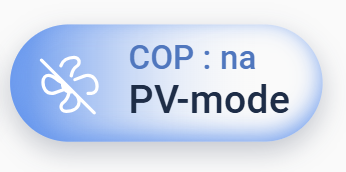

That is very cool, implemented it and pasted the full YAML below in case anybody else wants to see how far UIX can push a modest native heading badge :slight_smile:
