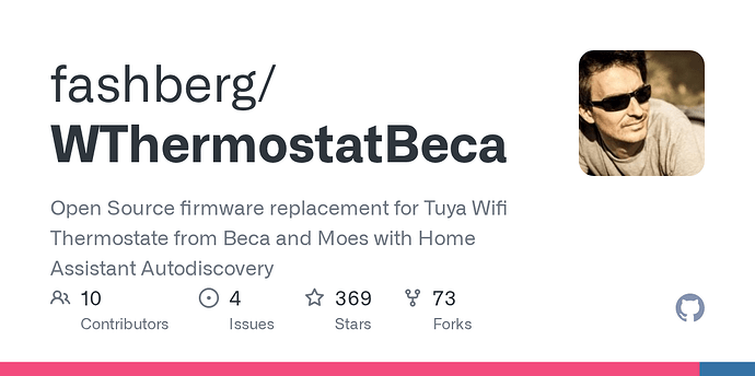

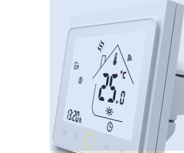

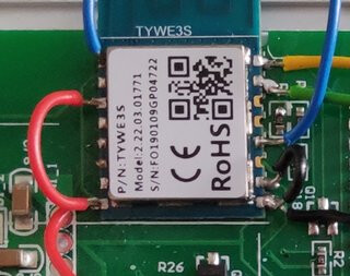

I replaced the same old thermostat with a MOES WiFi Smart Thermostat
I had to flash it with
Not sure if it’s as easy to do now but it was the first device for HA I flashed.
Flashed version doesn’t work of the cloud and can be used without HA. It’s so long ago I think I may have used the defunct tuya-convert over wifi(those were the days). Now you would have to attach to the pins and flash.
Yes looks like it has to be done by serial connection now.

Be aware that any Tuya device flashing instructions may be dated, where Tuya will replace the controller board with whatever the flavour of the month is. What was a simple flash on a ESP8266 can now be a different processor board altogether and require a completely different approach to customise to your needs.
