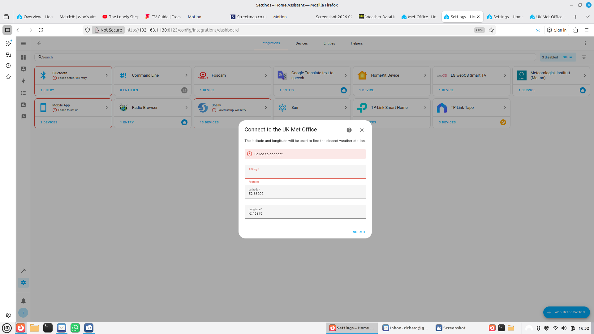

I’ve obtained a new API key and entered it., yet I’m getting Failed to connect.
I case it was me screwing up the API key , I’ve reset it and tried again. I deleted the old Met office integration, I still get failed to connect on the integration set up.
Does the HA met Office integration work since the Met Office changed their system ???

Yes I have, I’ve tried running that several times, gets to the point of entering the API key, and then fails to connect unfortunately
Okay, do you see this under Datahub site, or anything related in the logs?
Yes and :-

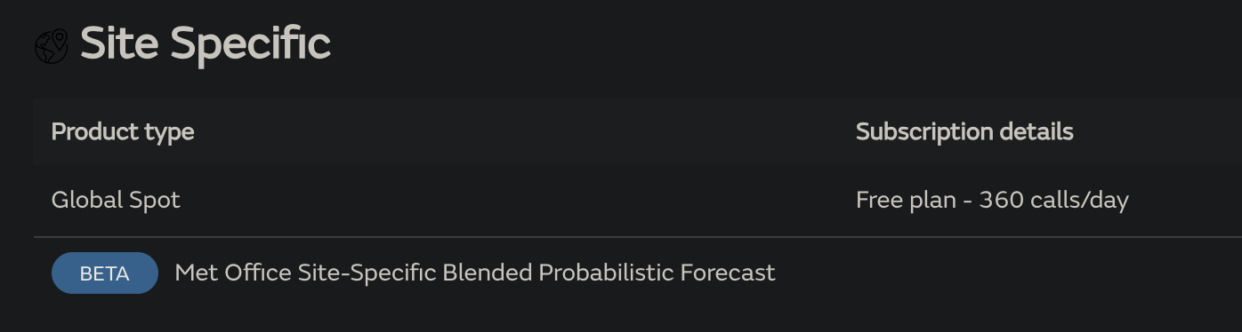

We are pleased to confirm that your recent application for a Met Office Weather DataHub plan subscription - Free - 55 Calls / Day for Richard Bown was approved on 09/02/2026 07:50.
It looks like you subscribed to the wrong plan. I see you’re using Site-Specific Blended Probabilistic Forecast which is a trial plan and limited to 55 calls/day for only 30 days.
You should be using ‘Global Spot’ which comes with free 360 calls/day.
Hi, I switched account to the 360 calls/day, reset credentials, got a new API
and got exactly the same failed to connect

That’s strange, but I doubt that has anything to do with it. Try removing the integration entirely and delete any leftover entities, then reboot HA/System. Then reinstall the integration again to see if any changes. If not, check HA logs for any errors and paste here.
Also, can you confirm you’re using latest HA Core?
Hi core version is 2024.9.1 that maybe the problem . I had deleted the previous integration and rebooted HA. I’ll update HA , thanks
Yeah, there’s the issue. The integration requires 2025.6+ to use the new api, it won’t work otherwise. :slight_smile:
