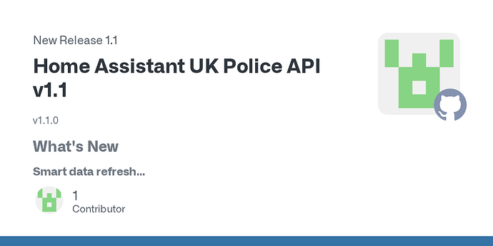

Noticed a couple of things that needed tweaking so v1.1 is now out!
