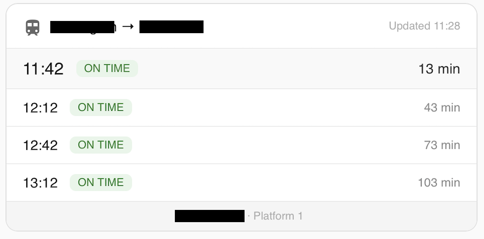

Same, the integration seems to be working well and I made a custom button card template for it if anybody finds it useful.

I built a custom button card if anybody would like to use it.
type: custom:button-card
entity: sensor.next_train_to_****
show_name: false
show_icon: false
show_state: false
styles:
  card:
    - padding: 0
    - border-radius: 12px
    - overflow: hidden
  custom_fields:
    i:
      - width: 100%
      - padding: 0
  grid:
    - grid-template-areas: "\"i\""
custom_fields:
  i: |
      const trains = entity.attributes.next_trains || [];
      const updated = new Date(entity.attributes.last_updated);
      const updStr = updated.toLocaleTimeString('en-GB', { hour: '2-digit', minute: '2-digit' });
      function getMins(scheduled) {
        const now = new Date();
        const [h, m] = scheduled.split(':').map(Number);
        const dep = new Date(now);
        dep.setHours(h, m, 0, 0);
        const diff = Math.round((dep - now) / 60000);
        if (diff < 0) return '—';
        if (diff === 0) return 'Now';
        return diff + ' min';
      function statusColor(status) {
        if (status === 'ON TIME') return '#2e7d32';
        if (status === 'CANCELLED') return '#c62828';
        return '#e65100';
      function statusBg(status) {
        if (status === 'ON TIME') return '#e8f5e9';
        if (status === 'CANCELLED') return '#ffebee';
        return '#fff3e0';
      const rows = trains.map((t, i) => `
        <div style="display:flex; align-items:center; justify-content:space-between; padding:10px 16px;
          border-bottom: 0.5px solid #e0e0e0; ${i === 0 ? 'background:#f9f9f9;' : ''}">
          <div style="display:flex; align-items:center; gap:12px;">
            <span style="font-size:${i === 0 ? '17px' : '14px'}; font-weight:${i === 0 ? '500' : '400'};">
              ${t.scheduled}
              ${t.estimated !== t.scheduled ? `<span style="font-size:11px; color:#c62828; margin-left:4px;">${t.estimated}</span>` : ''}
            </span>
            <span style="font-size:11px; padding:2px 8px; border-radius:6px;
              background:${statusBg(t.status)}; color:${statusColor(t.status)};">
              ${t.status}
            </span>
          </div>
          <span style="font-size:${i === 0 ? '14px' : '12px'}; color:${i === 0 ? '#333' : '#888'};">
            ${getMins(t.scheduled)}
          </span>
        </div>
      `).join('');
      return `
        <div style="font-family: sans-serif;">
          <div style="display:flex; align-items:center; justify-content:space-between; padding:12px 16px; border-bottom:0.5px solid #e0e0e0;">
            <div style="display:flex; align-items:center; gap:8px;">
              <ha-icon icon="mdi:train" style="color:#666; width:20px; height:20px; --mdc-icon-size:20px;"></ha-icon><div>
                <div style="font-size:14px; font-weight:500;">**** → ****</div>
                </div>
            </div>
            <div style="font-size:11px; color:#aaa;">Updated ${updStr}</div>
          </div>
          ${rows}
          <div style="padding:8px 16px; background:#f5f5f5; font-size:11px; color:#aaa;">
          </div>
        </div>
I masked locations for privacy
