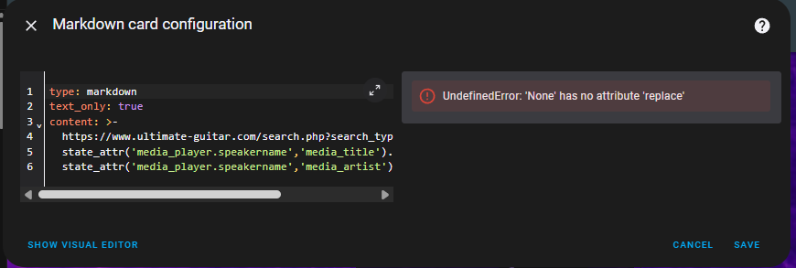

Sounds good! I just tried to add it to my dash and got an error. Granted, I’m not good in coding - very novice! :slight_smile:
Change the media_player.speakername references in the script to your media player entity name. You also need to make sure something is playing on the specified media player, otherwise you will get the UndefinedError: 'None' has no attribute to 'replace' error.
