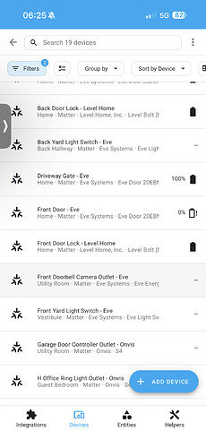

I have very similar setup, my thread border routers are Apple tv’s and HomePod minis and I leverage them to put my matter over thread devices into pairing mode from Apple home app and then add them into my HA instance. Even have a couple Eve matter over thread light switches in my setup.
Under debugging/Thread I have credentials for my existing Thread network. There are two sets of such credentials which are identical to each other except for the Border Agent ID. Presumably these came from two of my four border routers. Not sure why I have two sets as opposed to 1 or 4. How many do you have showing there?
It’s good to hear that you have some Eve Matter devices working with HA and that the devices were initially set up via HomeKit.
