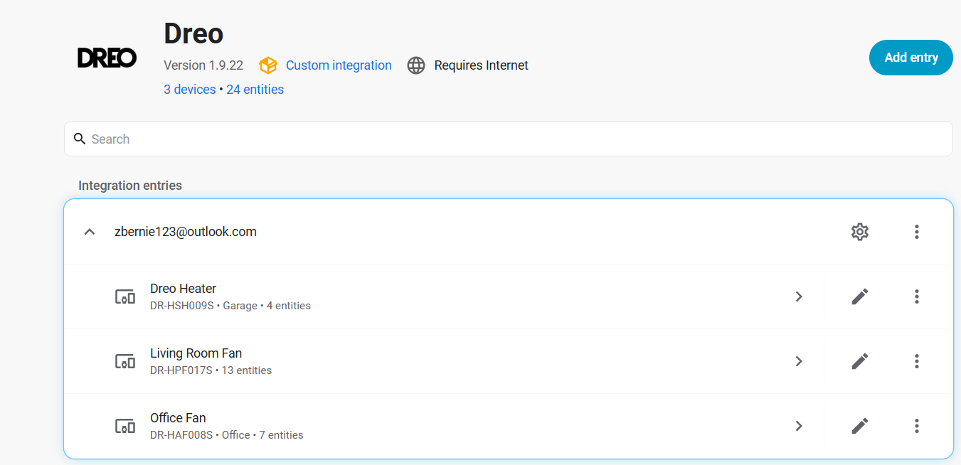

I've read that this fan is compatible with the Dreo integration, but I am unable to add it. I've added the fan to the DR-HAF003S fan to the Dreo app. I already have a Dreo table fan and heater configured in the integration. So far I've tried:

I installed the community Dreo integration and now I can see the DR-HAF003S fan.
