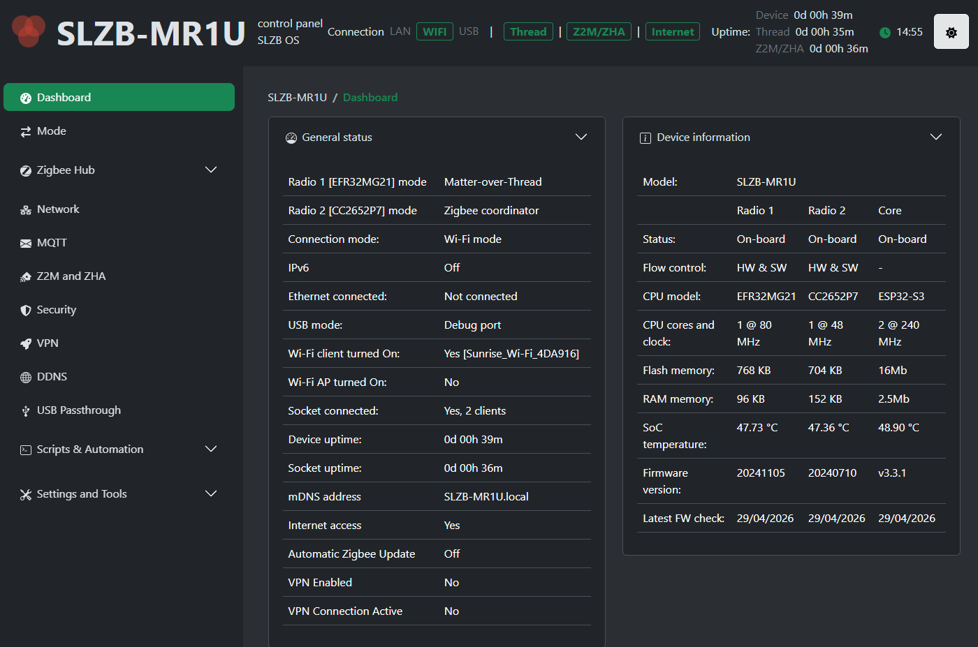

Here is my setup at the moment:
System information:
IPv4 addresses for wlan0: 192.168.1.192/24
IPv6 addresses for wlan0: fdaa:bbcc:ddee:0:a2f9:8d58:d78b:70fc/64, 2001:171c:2e67:1cd0:40be:5a73:9362:ac0a/64, fe80::5e49:95aa:631:7895/64
IPv4 addresses for end0: (No address)
OS Version: Home Assistant OS 17.2
Home Assistant Core: 2026.4.4
SLZB OS is updated with v3.3.1 and connected with wi-fi.
Radio 1 is assigned to matter, and radio 2 to Zigbee coordinator, since I read somewhere it is the recommended way to assign the radios. (However, I tried the other way around as well)
The firmware installed are the latest non-dev versions :
wlan0 ipv6 is set to automatic in HA and connected with wi-fi:

What I have tried so far:
  1. adding the device when it automatically pops up, i scan the QR and instead of “Google Home” , I choose “other apps” Home assistant
  2. Switching radio 1 to “Thread + OTBR running on device (experimental)”
  3. flashing latest dev frimware on radio 1
  4. Switching the radios, running Zigbee on EFR32MG21 and thread on CC2652P7
  5. Configuring SLZB-MR1U on ethernet instead of wifi
  6. Configuring SLZB-MR1U on USB connection instead of wifi
Note: In the dashboard of SLZB-MR1U, IPV6 says “Off” but there is nowhere in this version to switch this ON. I have downgrade the SLZB OS and in the tab network there is a switch to put it ON, but now it’s gone.
SO,
If you are still reading, thank you so much !!
Again, i’m not that technical, but it just seems like it never reaches the matter server, nothing happens in the logs when I try to pair the device.
Is my router the culprit or the SLZB-MR1U or my HA setup ? What shall I do now ?
