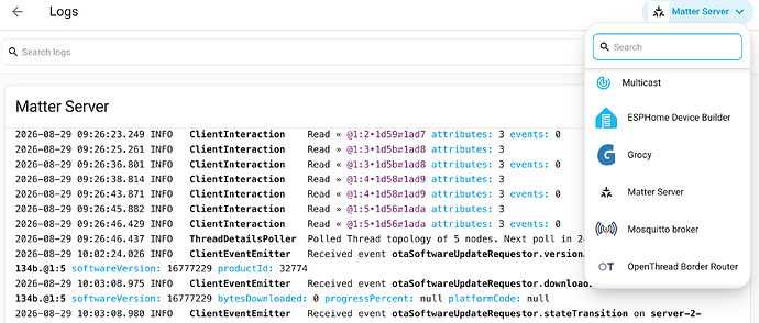

Settings → System → Logs → top right corner
