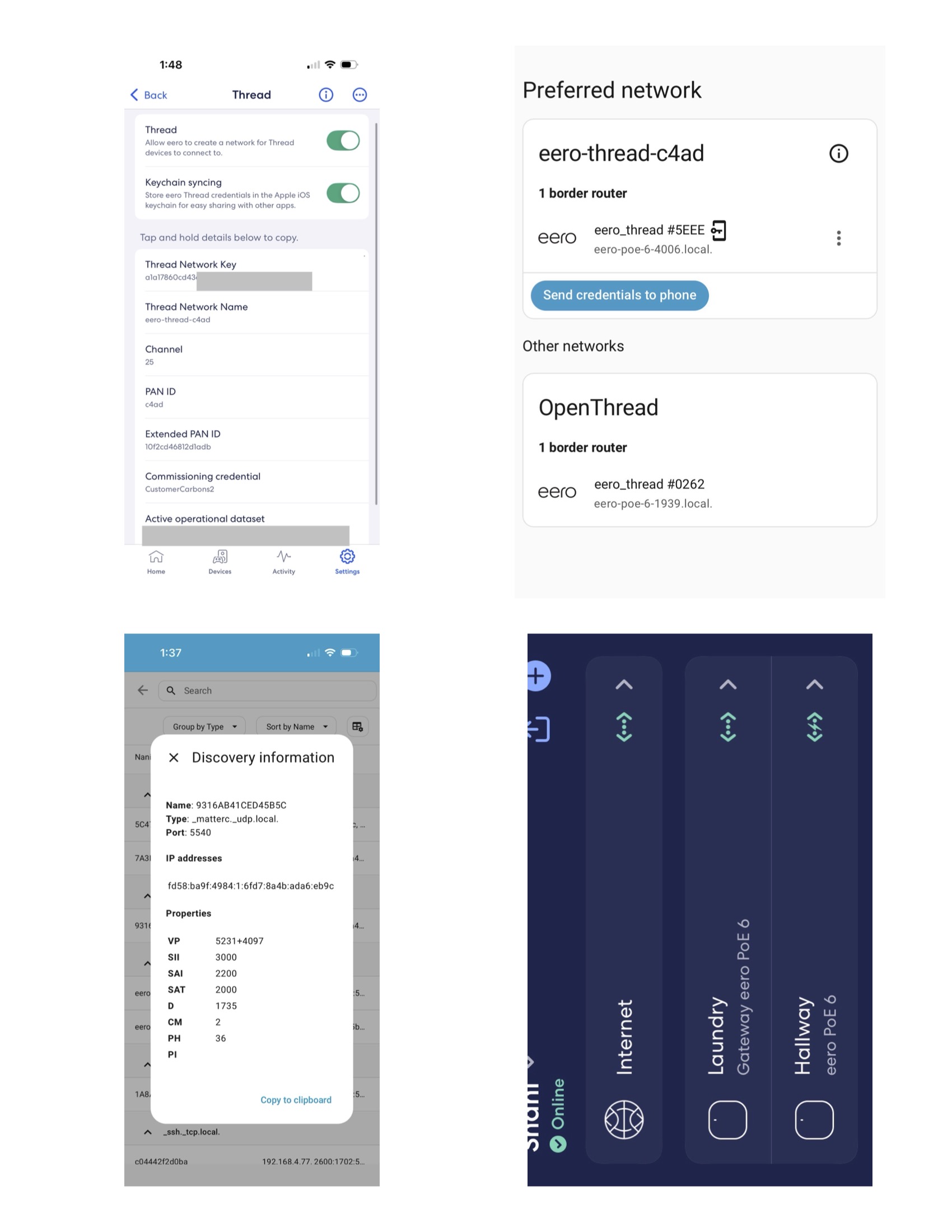

Setup:
I have two eero PoE 6 devices that act as thread border router. One eero is in gateway mode and the ATnT modem is in “IP Passthrough” mode. The second eero is connected to the first with wired backhaul.
I have IPv6 enabled in Home Assistant network settings and in Eero app.
I have Thread enabled in eero app also.
I have added the thread network credentials to Home Assistant using operational dataset and set the thread network as the preferred network. I also synced the credentials to my Iphone.
The problem
Whenever I attempt to add any matter device from my iPhone via the Home Assistant companion app, the screen indefinitely gets stuck on “Setting up…”. However, when I cancel out, I can see that the device gets added to my iPhone under “General → Matter Accessories”. It just never gets added to Home Assistant. When the device is in pairing mode, I did see it show up under the device discovery in Home Assistant network section.
In Matter Server network logs, I see some timeouts and failed to connect errors.
What I tried:
I tried generating ne thread network in eero, power cycles eero and home assistant, toggled ipv6 on/off, factory reset all the matter devices, cleared all eero/matter/thread credentials in ios keychain. There are no other thread networks apart from the ones the eero’s transmit.
Please help, I can’t figure this out!

Its a bit tough to figure out, but the iPhone wants to do a Matter (and Thread) Commissioning with the device first with the iPhone itself and then the iPhone wants to do a Matter “share” of the device to HA.
It appears that the iPhone was successful in commissioning with itself, and then started to share the device with HA. HA see this request and starts commissioning, finds the device through mDNS advertisements, and then HA tries to connect to the device and fails.
From here I can only take guesses, but if I had to guess, I would guess that either HA is not getting a route advertisement from the eerro TBR, or that HA is getting a route but to the other eero. Perhaps shut down the eerro for the “0262” Thread network and try it again.
Would be curious to hear if you have any progress with it
I have very similar setup and similar problem
Ive made it work, but it is very unreliable
What helped:
I did not sent credentials to HA, because in my case it does not have thread radio so it do not need to have credentials for network, iPhone will handle it while commissioning device
And in that config I could add matter device if I want close to the eero that HA is connected to, but it always times out if I try to connect near other eero
For some time working and non working eero switched for me after network reboot
So I assume there is some problem with routing traffic to HA to connect device and sometimes it is working with eero that is acting as main border radius, but it is unstable
Would be really great full for any help with debugging this and potentially fixing
