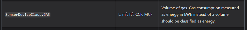

There is no device class “gas”
Yes it is called gas.
https://developers.home-assistant.io/docs/core/entity/sensor/
