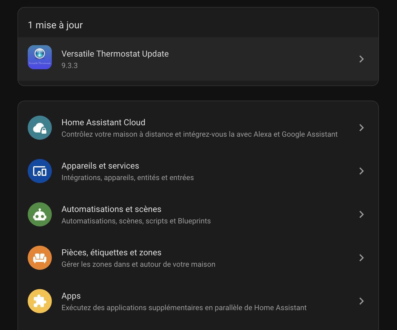

Here is an example.
Versatile can be updated, but when i click on the menu, nothing appens.
I needed to update using HACS Menu.

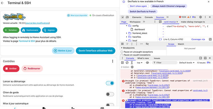

Do you see any errors in browser console when you click on an update?

When clicking, i can see this kind of error :
card-mod.js:5 Uncaught (in promise) TypeError: Cannot read properties of undefined (reading 'then')
at e.showDialog (card-mod.js:5:4762)
at d (make-dialog-manager.ts:183:19)

card mod? Isn't that a custom card? Have you tried disabling it +restart or restart in safe mode?
I'm fairly certain your issues are due to that, otherwise it wouldn't be just 2 people reporting it in 2 months.
i tried to removing CardMod module in HACS without any success.
I restart my VM but still same issue.
In Safe Mode, it's working fine.
Let's find the option that make it failed in full mode.
Looks like you have old (and very old) card_mod versions installed. Do you use minimalist theme or have you ever installed it? If so and it is old it may be loading old card_mod. In your Browser console, look at sources tab to see where both card_mod.js and lovelace-card-mod.js are getting loaded from which may point to what custom integration is loading it.
The latest version of card_mod (4.2.1) should work fine, though if you are want an actively maintained card_mod replacement, look to UI eXtension (UIX).
