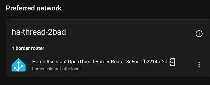

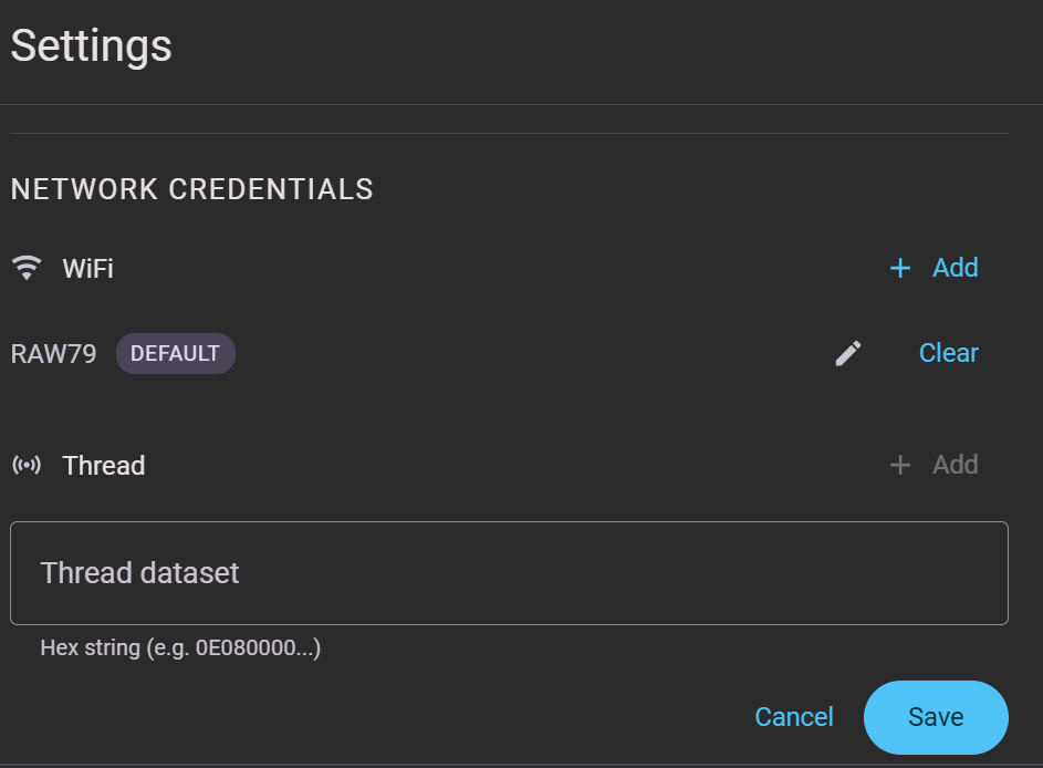

I think the problem is with the Open Home Foundation Matter Server configuration. When I navigate to Matter Server, Settings, Network Credentials, Thread network set, I am confused on what value to enter for the thread dataset.
This is the info I have on my thread entities:
THREAD
Network name: ha-thread-2bad
Channel: 15
Dataset ID: 01KMVED2VD6E3NVYZ41G0RJPS9
PAN ID: 2bad
Extended PAN ID: 353897e6b794a1d2
OTBR URL: http://core-openthread-border-router:8081
Active dataset TLVs: 0e080000000000010000000300000f4a0300001935060004001fffe00208353897e6b794a1d20708fd7a2600f7e966a905109a81cd3a1bf8b3b9cfb0da6339895c05030e68612d7468726561642d3262616401022bad04101a79d298b9a2ffd21dea0c40cbfd87d80c0402a0f7f8
Open Thread Border Router
Entry ID: 01KMVED0YQ8SVYR20WR2XK9PEJ
In case you didn’t know, this setup is for the Matter Server to do the commissioning directly (using a bluetooth device that Matter Server has access to) without using a mobile device. I mention this because you said earlier you were using Android which I assume is your mobile device you were using for commissioning.
If you indeed want to use the Matter Server to commission a Matter/Thread device directly, then you will want to configure the Matter Server’s “Thread dataset” to be a copy-n-paste of the Thread Integrations “Active dataset TLVs” which is the big long string starting with 0e08…ending with f7f8
Adding the long string to the Thread dataset fixed mobile device and direct thread new device commissioning. Thanks for your time and patience!!!
