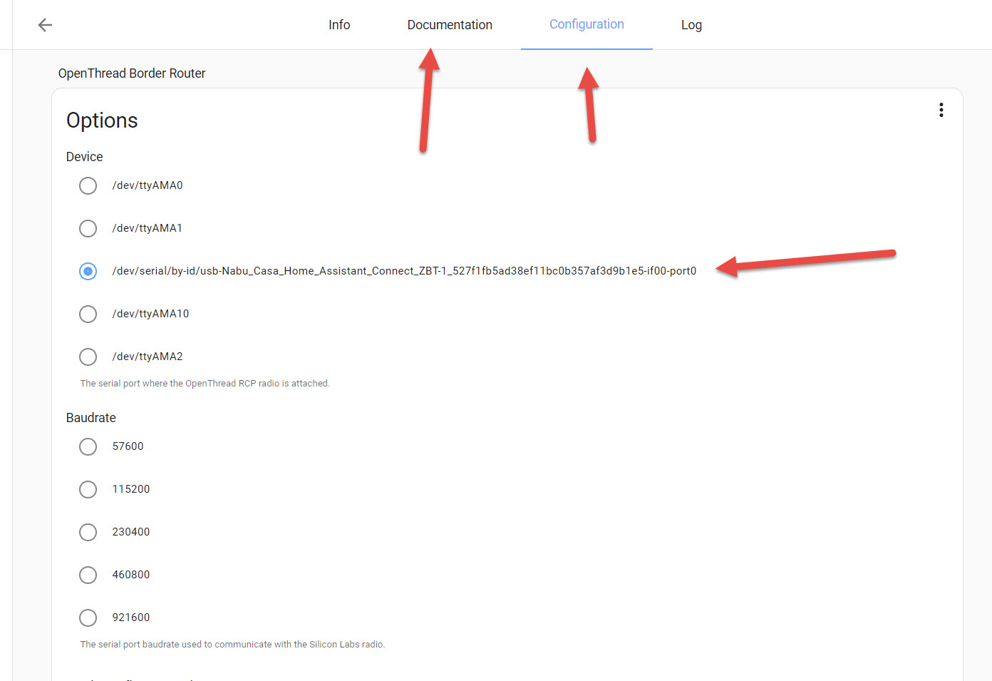

FYI - found the official thread setup instructions wrong for the ZBT-1; the ZBT-1 shows up as a device and that’s where the user selects it as thread or zigbee firmware. I then had to go back to “Settings > System > Hardware.” and “Home Assistant Connect ZBT-1” shows up now and user must select again thread or zigbee. At this point HA automatically installs the “Open Thread Border Router” add-on. However, the “Open Thread Border Router” add-on couldn’t find the ZBT-1. But listed in the “Open Thread Border Router” add-on documentation tab that the add-on configuration must be set to “/dev/ttyAMA1” for Home Assistant Yellow but this is only if using the internal HA yellow radio; I wanted the ZBT-1 radio which has a path that looks something like this:
/dev/serial/by-id/usb-Nabu_Casa_Home_Assistant_Connect_ZBT-1_527f1fb5ad38ef11bc0b357af3d9b1e5-if00-port0. So I think I maybe just needed to wait, or flash it via the “Silicon Labs Flasher” add-on.
Since I accidentally flashed the internal radio wrong, I disabled Zigbee and flashed the internal radio “/dev/ttyAMA1” without the ZBT-1 connected. I then restarted Zigbee.
Firmware for the ZBT-1 is supposed to automatically update by the “Open Thread Border Router” when the ZBT-1 is in thread mode (More about that here). However, it was failing. Disabled “Open Thread Border Router” add-on. Installed “Silicon Labs Flasher” add-on (install available via link at this page here). Make sure any integrations/add-ons that use the radio are disabled before flashing. Configured the flasher add-on to access the ZBT-1 via “/dev/serial/by-id/usb-Nabu_Casa_Home_Assistant_Connect_ZBT-1_527f1fb5ad38ef11bc0b357af3d9b1e5-if00-port0”.
I then enabled/re-started “Open Thread Border Router” add-on, thread and matter integrations and now ZBT-1 is showing firmware “up-to-date” with OpenThread RCP 2.4.4.0 (via SDK version 4.4.4 - full github filename: yellow_openthread_rcp_2.4.4.0_GitHub-7074a43e4_gsdk_4.4.4.gbl). Don’t forget to go back to any of the add-ons and enable “Auto update” if that’s your preference.

Ya, I figured all that out eventually and edited the above. Perplexity was saying both radios shared /dev/ttyAMA1 because they are both from Silicon Labs. AI is funny sometimes! Apparently the recommended path is a persistent path like /dev/serial/by-id/usb-Nabu_Casa_Home_Assistant_Connect_ZBT-1_. I think maybe I didn’t wait long enough for Open Border Router or ZBT-1 needed a manual flash before Open Border router used it. It’s working now. Internal radio is zigbee, ZBT-1 is thread.
