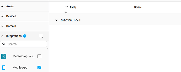

have done that and still have this, unless I am missing deleting the device. I did it under the mobile app link
This is what it shows for mobile App, will try once again, but has failed earlier.

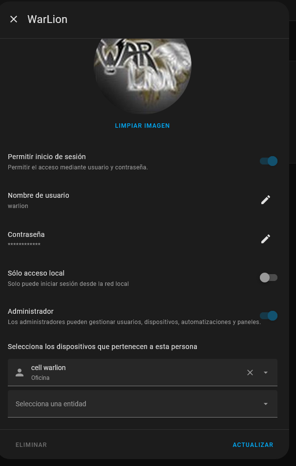

settings-> people-> your user profile
check if you have more that 1 instance

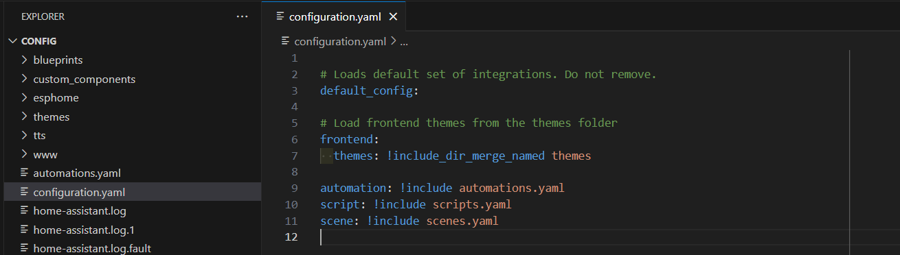

alsop share your config homeassistant (configuration.yaml)

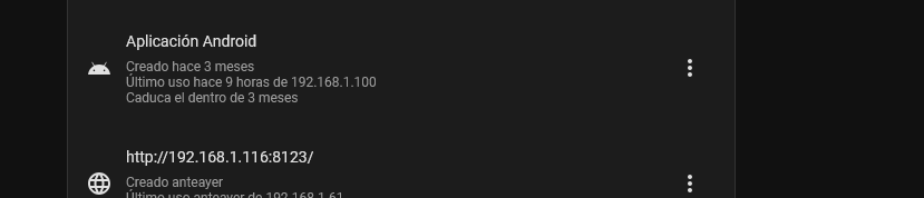

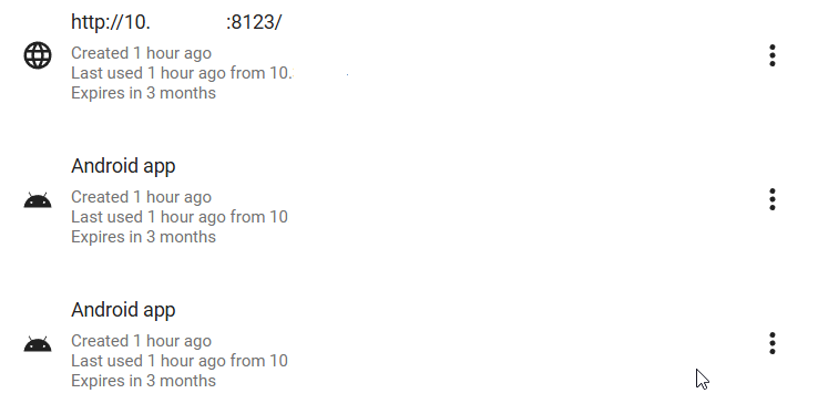

also try this
http://homeassistant.local:8123/profile/security
delete all tokens or the ones for android
ej.

and only one device associated with my person

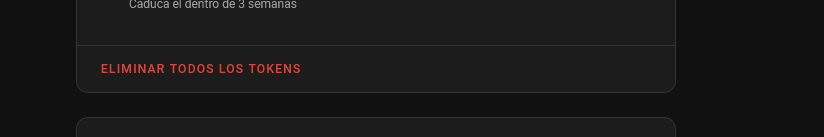

try deleting all tokens from http://homeassistant.local:8123/profile/security
***sorry if it is spanish but i dont want to change language
after that reboot twice , yes twice your home assistant
homeassistant sometimes delays removal of old device entries and tokens from .storage until after a full cycle
same error with new user. so try deleting all tokens again, and reboot HA twice and then try logging in?

Will delete all these and reboot HA twice.

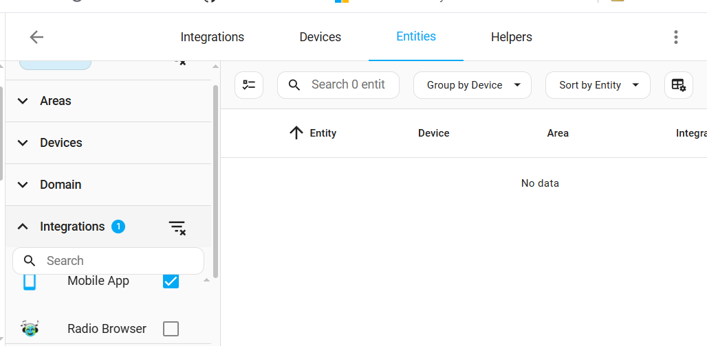

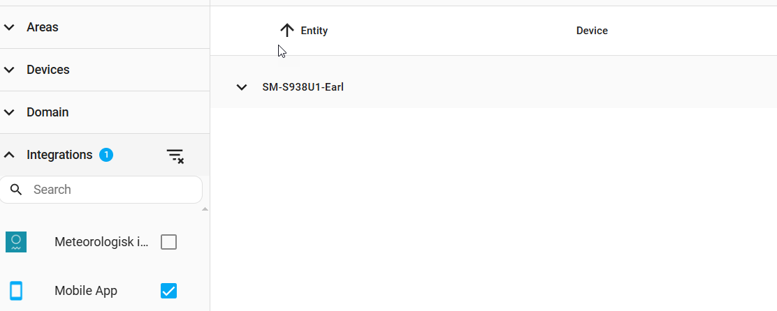

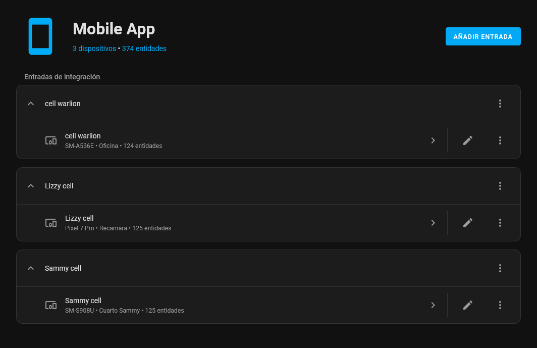

did you also remove the devises from Mobile App integration?

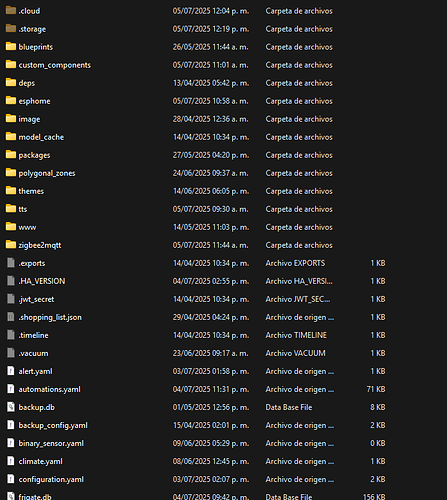

there is something a little more risky , deleting the json object of your device on device registry
but you need to be extra carefull here
.storage/core.device_registry
Search for your phone model or sm_s938u1
and remove the object
but is risky so be carefull
after that reboot
I had not but can remove them and reboot twice again, just finished rebooting twice.

Where is .storage/core.device and I have been using local IP to login.
is a hidden folder on your config
the second one
How do you get that to show, I am using code server and don’t see that
