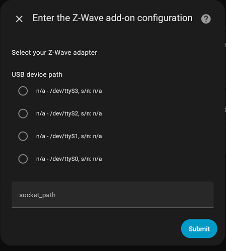

After installing Z-Wave JS…I headed over to devices…then clicked:
  1. Add integration
  2. Z-wave
  3. Recommended Settings
Then I get this:

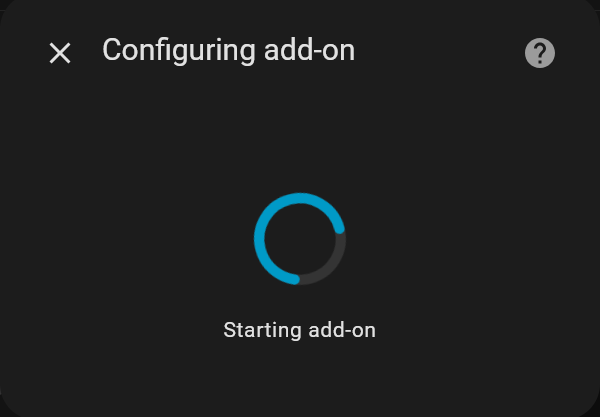

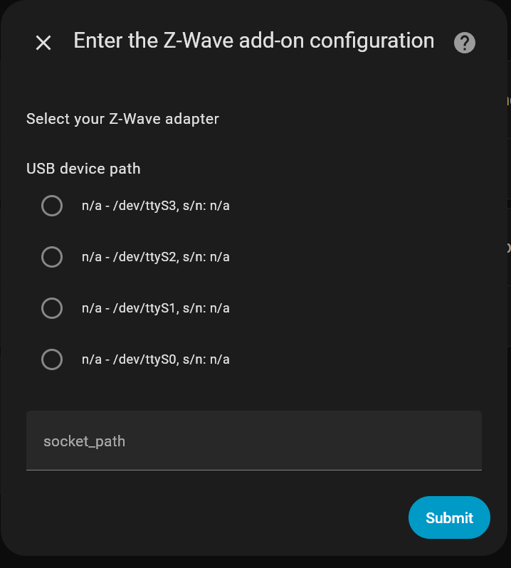

I have tried all four USB device paths, and they all get stuck on this configuring add-on screen:

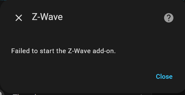

About 5 mins later I get:

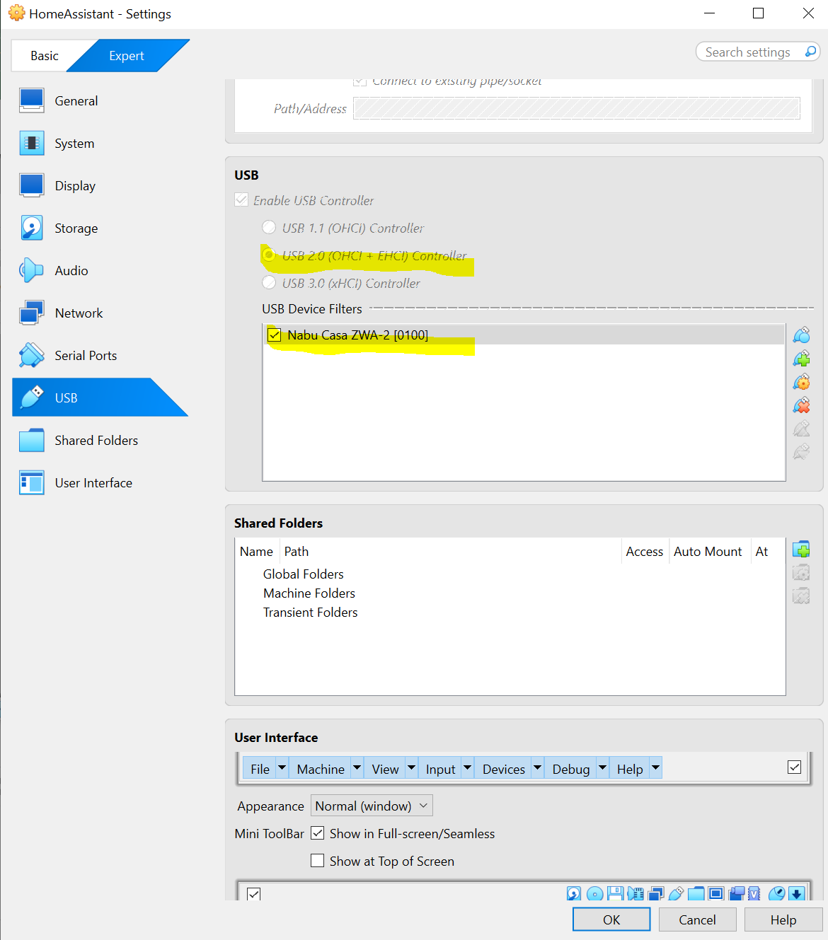

It looks like it was already enabled. But I added a filter for the ZWA-2, but did not change anything. I have the ZWA-2 plugged into USB-2 port, the light is on so I know there is power, and I know it’s detected in the virtual box because I was able to filter for it.

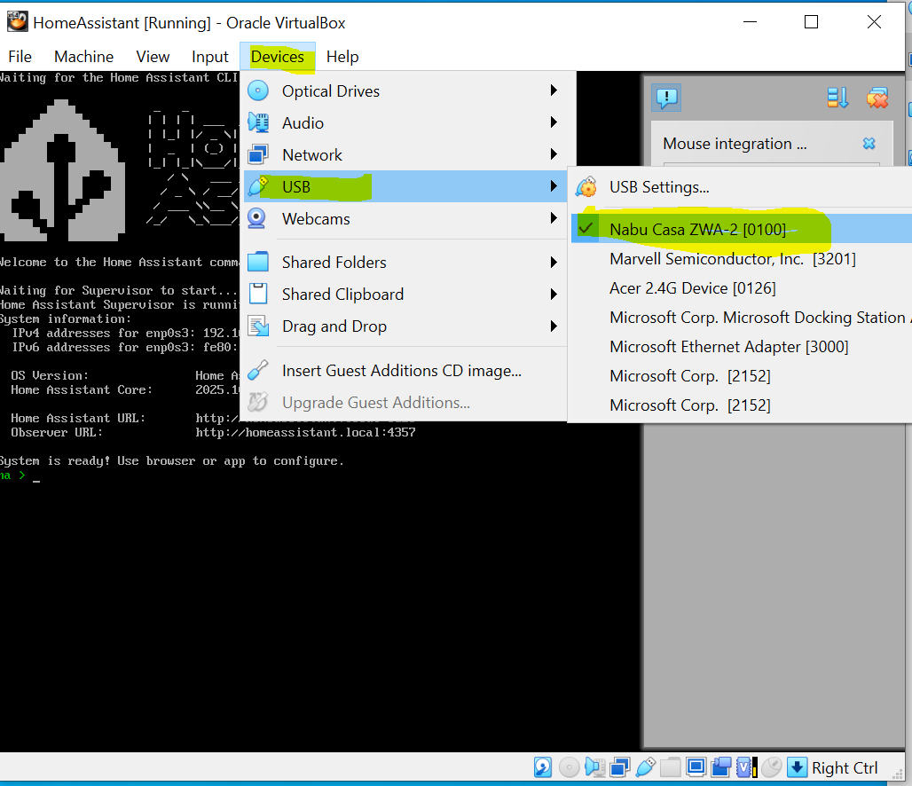

I Found it. I had to manually select the USB device from the Devices Tab in the home assistant window in Virtual Box.
