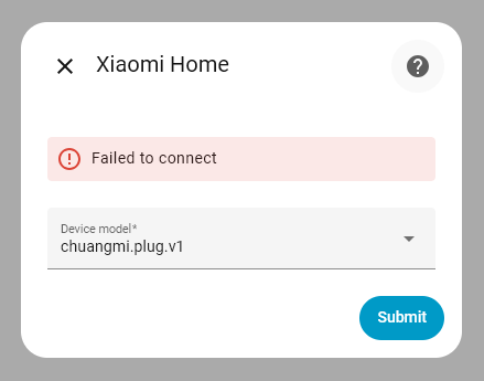

After manually entering the IP and token, I get a Failed to connect error. Does anyone have an idea why this happens?
Just had the issue and managed to solve it in my case. In particular:
  1. The automated method didn’t work for me so I had to chose manual
  2. The manual method failed for me initially because my device was accidentally disconnected. Similar to the image from @Pandaa
  3. After the device was reconnected and appearing on my Xiaomi mobile app, I retried again adding it via HA and it worked.
So looks like the manual method still works (at least it did for me)
