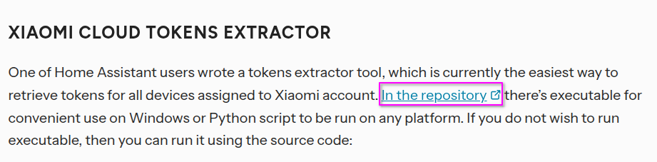

Actually the HA Xiaomi Home integration page does provide a link to the correct token extractor.

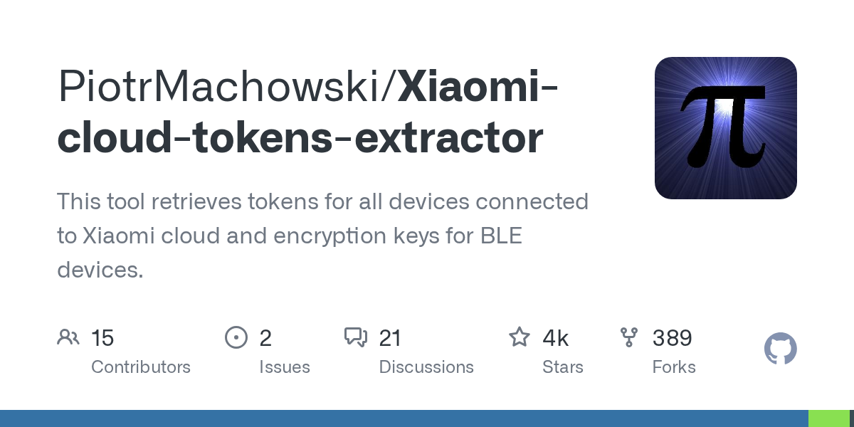

Hi, use the tokens from GitHub - PiotrMachowski/Xiaomi-cloud-tokens-extractor: This tool/script retrieves tokens for all devices connected to Xiaomi cloud and encryption keys for BLE devices., and setup manually using the “manual” option using tokens, then it works again. This is due to recent change on Xiaomi side.
