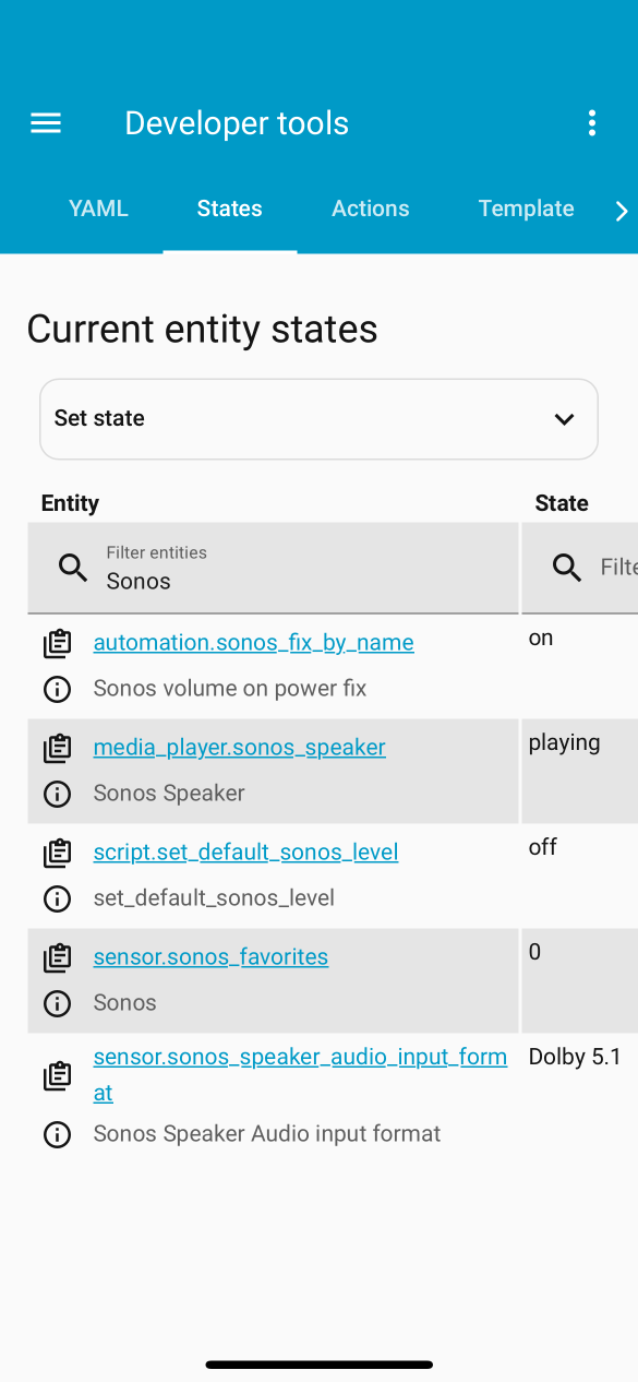

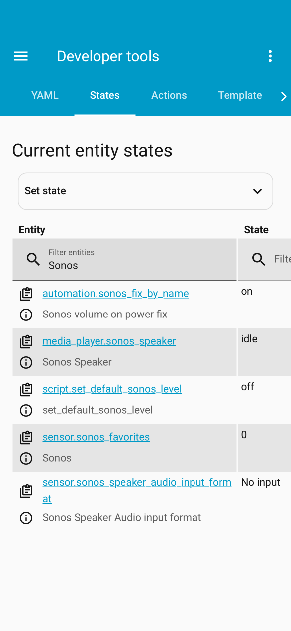

In terms of the entities, I can see these states when there is no Volume:
and these when there is Volume
I have a funny feeling, the Playbar goes into some form of hibernation and doesn’t become active until it receives an input on the remote, which then sets the audio_input_format from No input to Dolby 5.1 and the media.player_sonos_speaker from idle to playing
Is there a way I can set the values for these entities before I send the volume set or does anyone know if anything has changed with the Sonos integration?
