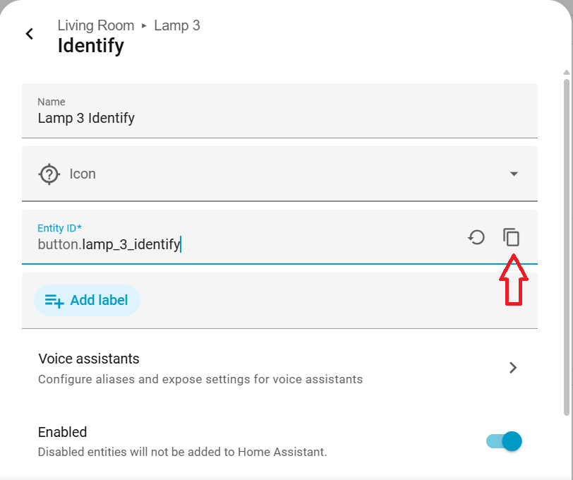

Is anyone else having an issue with copying an entity_id using the icon under the entities settings? I delayed the last 2 Core updates and just noticed this after updating to 2026.3.1. I’ve tried using Chrome and Edge on Windows as well as the Companion App on an iPhone. I know it’s not an issue with my mouse because the same copy action works in other apps such as Node Red. I will open a case if needed but wanted to confirm if anyone else is seeing this.
