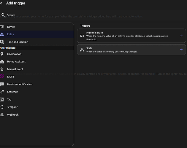

When I try to edit or create an automation, regardless if it’s a trigger, condition or action, as soon as I click on anything on the right hand of the screen “where my cursor is” in the photo, it takes my back to the default automation screen. I’ve tried rebooting and just did an update to the latest version with no luck.

I also have this issue. Unsure the cause. I can’t make or modify any automations, adding any sort of trigger just kicks me back to the list.
Tried incognito, different browsers, all the same.

I had exact same issue, rolled back to HA Core 2025.12.5 and issue is gone.
from CLI: ha core update --version 2025.12.5
Issue since 2026.1. Bug in this version. Rollback to 2025.12 solves it.
same issue here. Rollback to 2025.12.5 did not help
Clear your browser cache. Rollback seems to have worked for everyone else.
Had the same issue. It’s fixed in 2026.1.2
