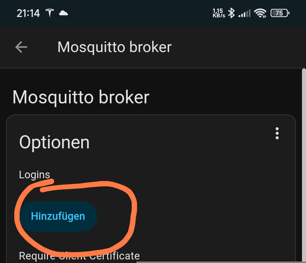

That prompted me to have another look at the MQTT integration - this time on my smartphone where I saw the “Login”. For some reason I was unable to locate it on the desktop.
@TFL999 , define MQTT login credentials in the settings and set the same info on your device. No need for an additional “person”
