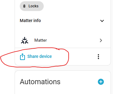

Once connected to HA then use “Share Device” to generate new matter code, just scan it with the camara and add it to apple home on the iPhone (on 2.4 WiFi) you want to connect. I do not have any apple hubs, I just added the lock to home on each phone, it sent me a warning that the lock is not in the same home but works.

Shared the code from HA to Apple Home
